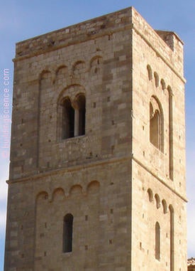

If you were rich like a King or a Pope you could have the entire wall built with nice carefully cut stones with nice tight joints. And if you were a real big dog King and a really rich Pope—and you weren’t cheap—you could afford to have your wall many layers thick with each layer being constructed of nice carefully cut stones with nice tight joints with every joint off-set horizontally and vertically (Photograph 1). Alas, Kings and Popes often tended to be cheap. Building multi layer assemblies out of shaped rock with nice tight joints—well—that really “rocked.” Too bad not much stuff was built that way. The stuff that was built that way lasted, and will last almost forever. “Forever,” is a pretty nifty “useful service life.”
Photograph 1: Multi Layer Stone Wall—A stone wall many layers thick with each layer being constructed of carefully cut stones with nice tight joints with every joint off-set horizontally and vertically.

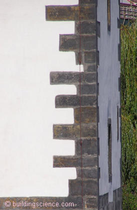

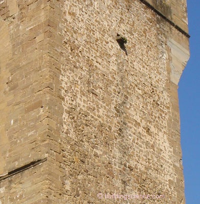

Sometimes builders gave their clients a nice outer layer and a nice inner layer and threw a lot of stuff (i.e. “rubble”) in between. Even more often, clients only got good stone corners and good stone lined “punched” openings with rubble comprising the majority of the wall (Photograph 2).
Photograph 2: Quoin Assemblies—Good stone corners and good stone lined “punched” openings with rubble comprising the “in-fill” of the wall.

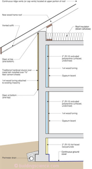

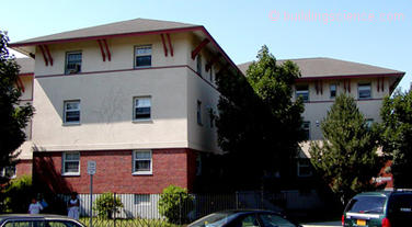

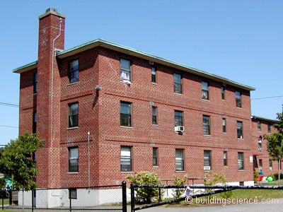

What can we do today if we took the lessons—good and bad—from Europe and North America and applied them to today’s old buildings? You can’t get worse than the building in Photograph 5—an uninsulated mass wall in Boston that is leaking rain, is cold, is uncomfortable, is an energy pig and is ugly to boot. Photograph 6 is what you can do if you have a great architect (Bruner Cott). Add overhangs, a pitched and vented roof, and a “stucco screen” that would make both Vitruvius and Henry III proud (Figure 2).
Be prepared to see a resurgence of stucco “over cladding” in North America. The over cladding stuccos need to be drained. And drained and insulated is even better. EIFS is coming back, and coming back in a good way, and just in time because we have lots of old buildings that are going to need it if we are going to be serious about this climate change, green and energy security thing.
Photograph 5: Face Lift Needed—Uninsulated mass wall in Boston that is leaking rain, is cold, is uncomfortable, is an energy pig and is ugly to boot.
Photograph 6: Saving A Building—Add over hangs, a pitched and vented roof, and a “stucco screen.”
Figure 2: “Stucco Screen”—A drained and ventilated “stucco screen” is installed on the upper portion of the wall—the portion of the wall that gets damaged because that is the portion of the wall that sees the rain.
