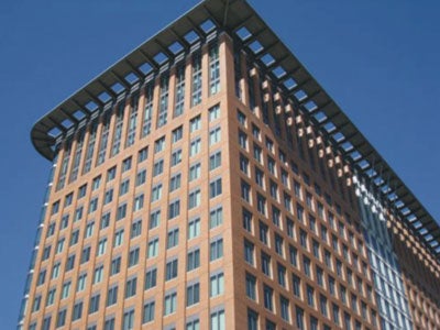

Figure 1:
A large modern office tower with highly efficient shape and window-wall areas.

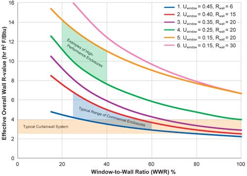

1.    Limit window-to-wall ratio (WWR) to the range of 20-40%, 50% with ultra-performance windows.
Windows should clearly be considered first: in terms of importance to energy consumption, the window-to-wall ratio (WWR)4 and window performance are likely the most significant decisions for a low-energy commercial or institutional building (Figure 2). Contrary to the belief of some, highly-glazed buildings (WWR>40%) in cold climates do notsave more daylighting energy than they lose in heat. Large swaths of south-facing windows also rarely collect more useful free heat during the day than they lose at night.  These are myths of a by-gone era where lights were very inefficient, and passive solar heating rules were still based on moderate, sunny climates in the US Southwest.
Figure 2:
The window-to-wall ratio dramatically influences the ability of the overall vertical enclosure to resist heat loss.
Given that modern commercial windows typically have overall (including frame) U-values of about 0.4 (R-2.5), and that walls can easily have R-values of 15, the disproportionate effect of window area can readily be appreciated. Such a combination would meet the ASHRAE 90.1 code and yet the overall average R-value is only R-5. High-performance glazing, i.e. systems with a U-value of less than 0.2 (R-5), can allow for higher window area with no energy penalty.
Numerous studies of commercial buildings have shown that the optimal WWR for energy performance centers around 25-35% in cold climates5.  However, the window area ratio is normally driven by the need for views, connection to the exterior, and quality of natural light, not energy use. As in most engineering analysis, the optimum area is a “flat” curve, meaning other design factors can allow the WWR to move to either side of the optimum with only small negative impacts on performance.

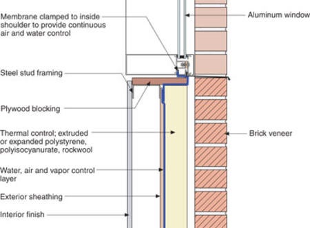

2.    Increase window performance (lowest U-value affordable in cold climates, including frame effects).
Heat flow through windows and curtainwalls is measured using the U-value. Today’s best-available commercial double-glazed windows, i.e., low-e coated, gas-filled units with fiberglass frames, can readily be procured with U-values of less than 0.3 (R-values over 3.3, USI < 1.7 W/m2K). Triple-glazed fiberglass frames with U-values under 0.15 (USI<0.8 W/m2K, R-7) are available for truly high performance. Triple-glazed units, especially with low-e coatings and gas fills, are almost always justified for low-energy buildings in climate zones 7 and 8, and as far south as zone 5. Alas, aluminum-framed windows and curtainwalls rarely achieve these performance levels: U-values of less than 0.35 (R-values over 2.8, USI < 1.9W/m2K) for double-glazed and 0.25 (USI<1.4 W/m2K, R-4) for triple-glazed units are often the best performance locally available.
To avoid unplanned heat loss through frames it is important to ensure two things: first, that the thermal control of the window frame (the thermal break) is aligned with the thermal control layer of the wall (normally the insulation layer, as in Figure 3); second,  that open frames are airsealed on both sides or (preferably) filled with low-expansion foam or pre-formed insulation inserts (Figure 4).
Figure 3:
Aligning the thermal control of the window frame (i.e., the thermal break) and IGU with the thermal control layer of the wall (insulation) is important to avoid thermal flanking.

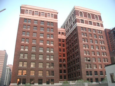

Figure 4:
Open window frames can allow air to enter and bypass even the limited thermal resistance of the frame. Filling the frame with low expansion foam on site, or, preferably, performed insulation in the factory, minimize this impact.

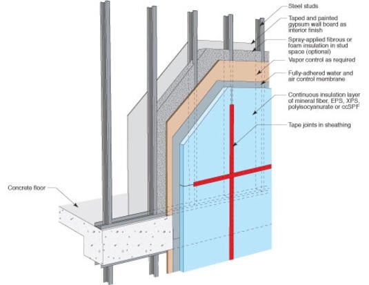

Increase wall/roof insulation (especially to control thermal bridging) and airtighten.
Increasing insulation is perhaps an obvious step in improving energy efficiency. However, where the insulation is added in an assembly is just as important as how much: in many modern commercial enclosures, the majority of lost R-value is due to thermal bridging around insulation6. Air leakage through enclosures can similarly bypass insulation and render it effectively useless.
In commercial and industrial buildings, steel framing and concrete block masonry are common assembly types and are prone to serious thermal bridging; when insulation is added only between studs or within the voids in concrete blocks, heat easily travels (or “bridges”) around the insulation, through the steel or concrete, and via floor slab penetrations. As new codes and standards are developed and widely adopted, continuous insulation, or “ci,” will become the standard approach, as only ci insulation is all or mostly effective R-value.
Figure 5: Exterior insulation can be installed in a continuous and essentially unbroken blanket, ensuring the effective R-value is close to that specified.
Little benefit is derived from insulation installed within the framing of a steel stud wall, where thermal bridging through the floor slabs and studs will reduce R-13 to R-19 stud bay insulation to an effective R-5 or R-6. Adding 7” of R-6/inch insulation to the hollow voids of a 10” concrete masonry wall will provide an effective insulation value of only approximately R-5 to R-7 in most applications. A major advantage of continuous exterior insulation, especially in steel and concrete enclosures, is the blunting of thermal bridges at floor structures. Simply adding thickness to the exterior continuous insulation layers allows one to reach very high true R-values and reduce condensation risks. In some cases the modest additional R-value gained from studspace insulation may justify the risk and effort of installing it.

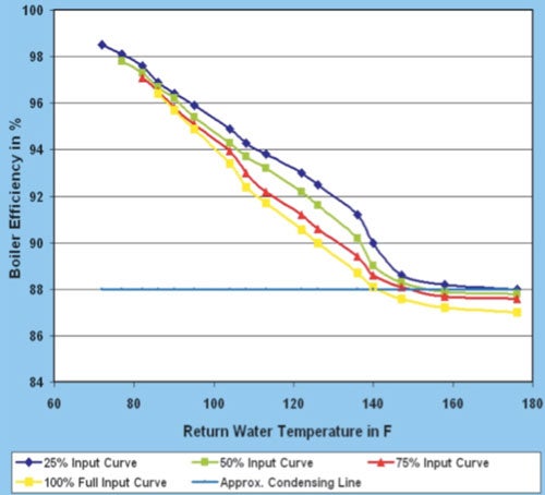

8.   Improve boiler and chiller efficiency & recover waste heat
Modern boilers and chillers are often efficient.  However, for low-energy buildings, it is often worth selecting the best-in-class or close to it for these primary units.  For example, natural gas boilers with 92 to 96% efficiency do save non-trivial amounts of energy relative to more commonly-selected 82-88% efficient units.  Mid-size water-cooled chillers can have integrated part load efficiencies (IPLV) of as low as 0.3 kW/ton (a COP of 11!), rather than the ASHRAE-minimum 0.6.
However, the system into which a boiler or chiller is integrated is at least as important as the unit itself. There are no high-efficiency condensing boilers available that can achieve high, i.e. 95%, efficiency if they are not installed in a system that returns water below about 120 °F / 50 °C. There are also boilers rated at 92% that can easily outperform units rated at 96% if the latter are fed return water at high temperature and the former are fed cooler water (such as from radiant floors or low-temperature fancoils). Even more critical to energy use is the system into which a chiller is integrated.  Many a high-efficiency chiller or ground-source heat pump has not met the hopes of low energy use because of excess pump and fan energy caused by bad selection, poor control, small pipes and ducts, and other design issues. Hence, keeping a sharp eye on system energy performance under the likely operating conditions is far more important than selecting the most efficient units.
Figure 6:
Efficiency curve for a high-efficiency natural gas boiler. The return water temperature
from the heating loop has a very important impact on the potential efficiency.
