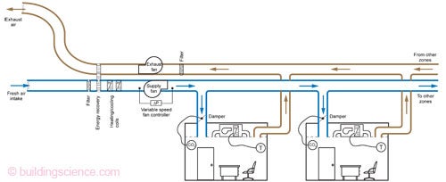

Figure 2:
A multi-zone direct outdoor air system that dehumidifies supply air to offset occupancy and ventilation humidity, controls the ventilation rate dependent on occupancy, and heats or cool individual spaces with a radiant or fancoil terminal unit controlled by a space thermostat.
Other more economical approaches can be used that provide very close to the same performance. For example low-velocity fan coil units with dry coils and ECM motors that take air from the space and mix conditioned air back into the space are now available.5 Not only are these less expensive than radiant systems, they have a faster response time. Valence cooling and baseboard heating panels are other options.
A dedicated outdoor air system (DOAS) should be used in multi-zone or large single zone spaces to provide neutral temperature ventilation air independently of heating or cooling. Such a system will ideally incorporate some form of HRV or ERV.  In multi-story buildings, a separate floor-by-floor DOAS is preferred to deal with duct penetrations through floors. Variable speed air handlers that maintain a constant pressure in the supply ducts should be the standard choice for this application.  The use of a DOAS avoids the too common indoor air quality problem of re-circulating polluted air from one space or occupancy to another.6
Ideally, separate dehumidification equipment should be provided in each space. Practically speaking, most of the humidity load comes from the ventilation air and occupancy, and hence adjusting the supply air humidity level in a DOAS ventilation system can be used to control the humidity level within reasonable limits (e.g., +/-5% RH).
