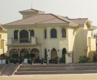

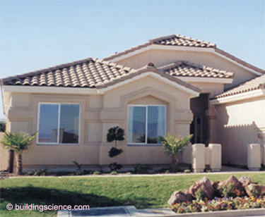

The houses in Vegas and Dubai look pretty similar with stucco everywhere (Photographs 1 and 2). But, their similarity ends with the looks.
Photograph 1: Las Vegas Home
—Stucco, tile roof, in a subdivision in the middle of the desert.

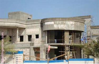

Photograph 2: Dubai Home
—Stucco, tile roof, in a subdivision on a man-made sandbar in the middle of the Persian Gulf surrounded by desert.

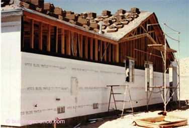

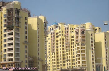

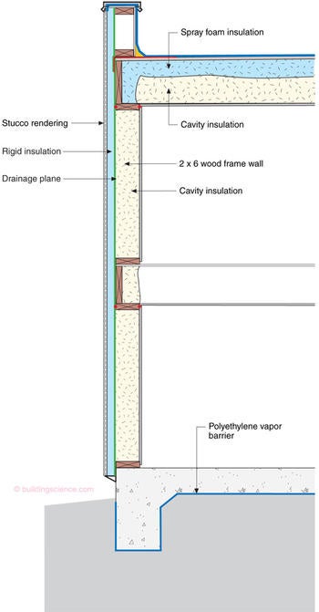

In Vegas, residentially, we see lots of stucco installed over exterior insulation, over insulated wood frame structures (Photograph 3). In Dubai, residentially, we see lots of stucco installed over uninsulated masonry walls (Photograph 4). Roofs in Vegas are tile with light-colored membranes over insulated wood truss assemblies (Figure 1). Roofs in Dubai are tile with light-colored membranes over uninsulated concrete slabs (Figure 2). Windows in Vegas are nonconductive vinyl and wood-framed, low-E2 gas-filled glass. Windows in Dubai are conductive aluminum, single-pane tinted glass. Air conditioners in Vegas are small and efficient. Air conditioners in Dubai are huge and not efficient. Residential construction is “tight” in Vegas with controlled ventilation. Residential construction in Dubai is also “tight” but with no provision for controlled ventilation beyond that of operable windows.
Which makes more sense in an unbelievably hot climate: residential construction in Vegas or Dubai?
Photograph 3: Under the Las Vegas Stucco
—Wood frame (2x6) externally insulated with expanded polystyrene installed over a drainage plane. Thermal resistance is nominally R-25. Tile roof is installed over unvented conditioned wood frame insulated assembly. Thermal resistance is nominally R-35.
Photograph 4: Under the Dubai Stucco
—Concrete masonry units are not insulated. Thermal resistance is nominally R-8. The roof membrane is installed over an unvented, uninsulated conditioned concrete slab. Thermal resistance is nominally R-8.
Figure 1: Residential Las Vegas Section
—Stucco installed over exterior insulation, over wood frame structures. Roofs are tile with light-colored membranes over insulated wood truss assemblies. Windows are nonconductive vinyl and wood-framed, low-E2 gas filled glass.

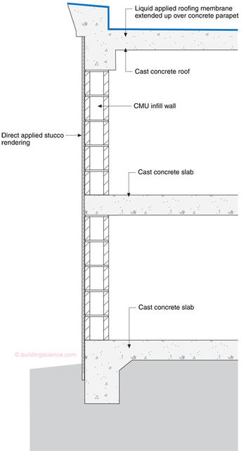

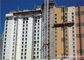

In Vegas, commercially, on the small stuff (less than 20 stories), we see lots of stucco installed over exterior insulation over steel studs (exterior insulation finish systems [EIFS]) (Photograph 5). In Dubai, commercially, on the small stuff, we see stucco over uninsulated masonry infill walls (Photograph 6). In Vegas, commercially, on the small stuff, we see light colored insulated built-up compact roofs over light truss construction. In Dubai, commercially, on the small stuff, we see light colored uninsulated concrete roofs.
Photograph 5: More Las Vegas Stucco
—Concrete frame, steel stud backup walls sheathed with paperless gypsum. Exterior insulation is EIFS. Thermal resistance is nominally
R-20.
Photograph 6: More Dubai Stucco
—Concrete frame, masonry backup wall has direct-applied exterior stucco. Thermal resistance is nominally R-8.

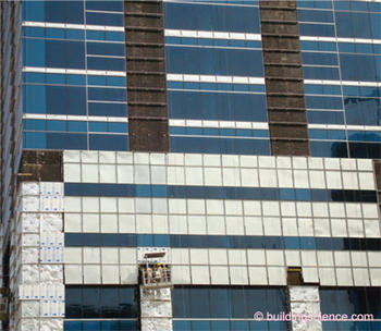

On the big commercial stuff in Vegas and Dubai, the roofs are the same: light-colored, insulated, built-up, compact roofs over light truss construction. On the big commercial stuff in Vegas we see lots of insulated curtain walls. On the big commercial stuff in Dubai, we also see lots of insulated curtain walls; but we see them installed over solid masonry infill rather than steel studs (Photograph 7). Even the interior partitions are solid masonry. All of this masonry weighs a great deal. The structural loads are huge and drive up costs big time. However, costs are apparently irrelevant.
Photograph 7: Typical Dubai Curtain Wa
ll—The curtain wall is pretty much an uninsulated cladding that is installed over a CMU backup wall that is externally insulated with foil-faced rock wool. Note that the CMU is coated with a liquid-applied dampproofing. This is a good start. However, the liquid-applied dampproofings commonly used in Dubai are too thin to do much of anything. They don’t do much for the rain control (but there is not much rain to worry about in Dubai). The key is that they are not effective air barriers as the assemblies are too air porous, and air barrier continuity is missing at punched openings (this is a big deal). This pretty useless thin stuff could easily be replaced with a “for-real” drainage plane/air barrier membrane (liquid applied) coupled with some minor detail changes at the punched openings. This change would be huge. Now, if you want to save costs, the CMU backup wall could be replaced with a steel stud wall with exterior paperless gypsum board. Think of the weight and resources saved? This configuration would actually be better than most curtain walls in Vegas, London, and New York. Oh, yeah, I almost forgot—the window area should be reduced, but you all knew that.
Which makes more sense in an unbelievably hot climate: commercial construction in Vegas or Dubai?

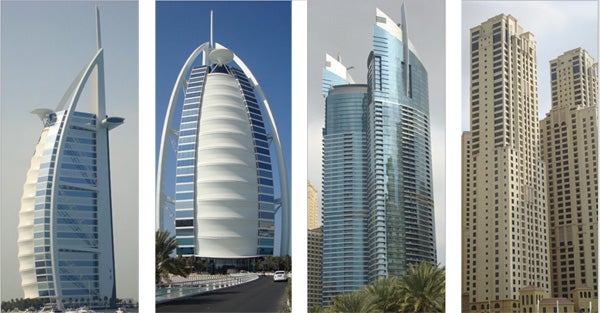

The Burj Al Arab grabs you (Photographs 8 and 9). I think it is one of the most beautiful buildings in the world. I saw it first in the middle of the day. I came back that night and then again twice during the next few days. It’s that kind of a building. Architect Tom Wright created a masterpiece. The structural engineering is equally impressive. But try as I might I couldn’t overlook the environmental control. It’s a sickness I have. At the end of the day I was wondering, “what were they thinking?” The Burj Al Arab is little more than a 1,000 ft (305 m) air-conditioned tent with glass sides in the middle of the desert. Yes, the most beautiful glass-sided, air-conditioned tent in the world, but an air-conditioned, glass-sided tent, nevertheless.
It is clear that most folks in Dubai have caught the “architectural glass and curtain wall disease,” which is a viral-like infection that has spread from London and New York to infect the globe (Photograph 10). This building could be anywhere, but it is particularly galling located in Dubai. It’s clearly not done by an old, wise Arab architect. It was probably done by some award winner from London or San Francisco. The wise, old Arab architect likely did this one (Photograph 11). Too bad the glass towers outnumber the others by a wide margin in Dubai.
Photograph 8
(far left): The Burj Al Arab—I think it is one of the most beautiful buildings in the world. Notice the glass sides. Photograph 9 (middle left): Fabric cladding. Thousand foot (305 m) tall air-conditioned tent with glass sides in the middle of the desert. Yes, it is the most beautiful glass-sided, air-conditioned tent in the world, but it is an air-conditioned, glass-sided tent, nevertheless. Photograph 10 (middle right): “Architectural glass and curtain wall disease.” This is a viral-like infection that has spread from London and New York to infect the globe. This building could be anywhere, but it is particularly galling located in Dubai. Photograph 11 (far right): This is more like it. Too bad the glass towers outnumber these by a wide margin in Dubai. Now, if they would only use better glass and be airtight and not overventilate. Vegas could learn a little from this.
