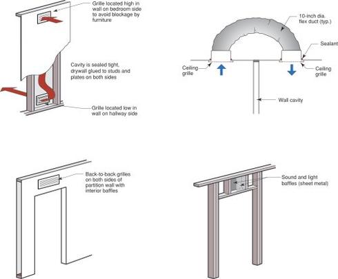

Ducting - Single return requires transfer grilles to provide path and avoid pressurizing bedrooms as shown in accompanying figures. Appropriate sizing for ducts, including these pressure relief methods, can be found in the technical resources listed above. See Figures 3a-d.

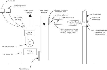

Controlled mechanical ventilation - Intermittent central-fan-integrated supply, designed to ASHRAE 62.2P rate, with fan cycling controls set to operate the central air handler as much as 33% of the time, but not less than 25% of the time, occurring within at least every three hours to provide ventilation air distribution and whole-house averaging of air quality and comfort conditions (installed cost: $125 to $150). Optionally include a normally-closed motorized damper in the outside duct with the AirCycler FRV control (installed cost: $50 to $60). See Figures 4, 5 and 6.

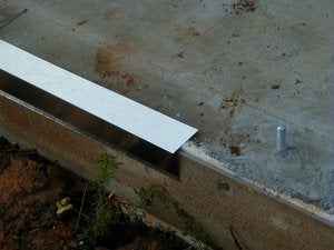

Termite control – Local codes and interpretations by building inspectors can make details involving slab insulation difficult. We have found that building officials accept the flashing/fiber cement board shown in the building profile and Figure 7.
Figure 7
Termite flashing continuity – In order for the metal flashing to be effective, all joints must be epoxy-sealed (or welded) and the horizontal edge must be epoxy-sealed to the concrete.

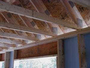

Energy trusses – There are a number of different truss configurations that yield greater depth at the heel, but they vary quite a bit in cost. The truss shown in Figure 8 (sometimes called a “slider” truss) has proven to be among the most cost-competitive. And of course, the pitch of the roof affects just how much insulation you can get at this location, regardless of the type of truss.

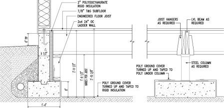

Conditioned crawlspace – Conditioning of the crawlspace means that this space must be constructed much like a living space; it must be supplied by the HVAC system and have a transfer grille to return air back to the HVAC system located in the living space. The supply air should be directed horizontally across the crawlspace with good enough "throw" to provide some mixing, not directed down at the floor. Sizing of the supply air should be about 5% of the conditioned crawlspace floor area (for example: 0.05cfm/ft2*1600ft2=80 cfm for a 1600 ft2 conditioned crawlspace). A single 6" diameter supply duct typically suffices. Transfer air should go back to the central area of the living space above the crawlspace. Two grilles (10 inches by 4 inches) on opposite sides of the crawlspace will usually be sufficient. The transfer area should be calculated in the same manner as for closed bedrooms connecting to hallways, using the 3 Pa pressure difference limit. Some form of mechanical moisture control for the crawlspace is necessary. We recommend one of the following approaches:
Controlled ventilation strategy using the intermittent central fan-integrated supply; it provides both mixing and moisture removal for the crawlspace as well as the house.
A stand-alone dehumidifier installed in the crawlspace.
A continuously-operating crawlspace exhaust fan with make-up air extracted from the house.
In this assembly the rigid insulation is applied to the interior face of the exterior foundation walls. Moisture control is important to proper performance, in particular the vapor barrier ground cover on the floor of the crawlspace. The vapor barrier must be continuous and sealed to the perimeter wall and any supporting piers.
