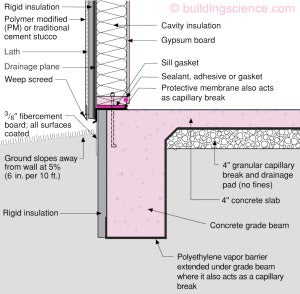

Adding insulation outside of the slab edge will allow the inside surface temperature of the slab perimeter to more closely track interior conditions thereby reducing the potential for condensation and elevated relative humidity. The strategies available for insulating the slab edge depend upon whether the slab on grade is 1) monolithic with a grade beam, or 2) supported on grade and independent of the foundation wall.
When the slab is monolithic with a grade beam, the insulation must be installed to the exterior of the slab edge/grade beam and continue vertically to the bottom of the grade beam as shown in the example to the right. The insulation material must be appropriate for ground contact. XPS, rigid fiberglass and rock wool are examples of acceptable materials. The exterior insulation will need to be protected from impact damage during construction and, subsequently, the above grade portion must be protected from UV and impact damage on the above grade portion.

Slab Edge Insulation Details
Figure 1
Perimeter Insulation of Monolithic Slab-Grade Beam
- Insulation extends to bottom of grade beam
- Protection board over above grade portion of rigid insulation
- Protection board of non-water sensitive material and coated to control absorption of water
- Protective membrane adhered to slab and wrapped over top of insulation
- Insulation material non-moisture sensitive and not subject to degradation with ground contact
