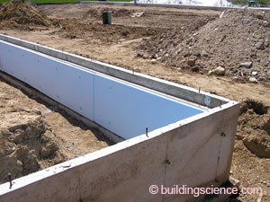

Check out a project of about 1,000 houses near Chicago constructed about 10 years ago. Photograph 1 shows rigid insulation full height on the inside of the stem wall. Note the deep “seat” cast into the inside of the top of the stem wall. This “seat” will receive the perimeter edge insulation and the perimeter slab insulation as well as the concrete. Photograph 2 shows the perimeter slab edge insulation and the perimeter slab insulation. We have found that 2 inches of rigid insulation is about the maximum practical thickness possible. That yields about R-10 if you are using extruded polystyrene (XPS) – which is the most common product - which provides comfort – based on our first hand experience up to Minneapolis.1  Notice that the sheet polyethylene “vapor barrier” is located on the top of the rigid insulation between the rigid insulation and the bottom surface of the concrete – in direct contact with the concrete. Do not, and I repeat, do not locate the polyethylene under the insulation as it will keep the insulation wet. Trust me on this – or go back and read “BSI-003: Concrete Floor Problems.”
Photograph 1: Insulated Stem Wall
—Rigid insulation full height on the inside of the stem wall. Note the deep “seat” cast into the inside of the top of the stem wall. This “seat” will receive the perimeter edge insulation and the perimeter slab insulation as well as the concrete.

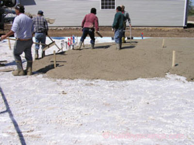

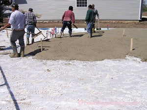

Photograph 3 the concrete being placed on the top of the sheet polyethylene and a layer of XPS insulation. Notice that there is no welded-wire mesh. No one ever puts it on chairs so that it is actually in the concrete instead of on the plastic. Why bother? It ends up just being expensive “ballast” to hold the plastic down. We use stones to hold the plastic in place. What about cracking? Use fibers and a water-to-cement ratio of less than 0.5 and control joints.
Photograph 3: Concrete Placement
—Shows concrete being placed on the top of the sheet polyethylene and a layer of XPS insulation. Notice that there is no welded-wire mesh. Stones – gravel keep the plastic from blowing away.

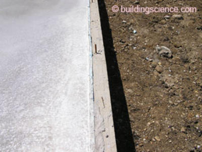

Photograph 4 is a thing of beauty. A thermal break worthy of great artisans. Now install a strip of waterproofing set in mastic that spans the rigid edge insulation and acts as both a capillary break and an insect barrier. Do not underestimate insects – especially termites. Always treat the ground with a fipronil-based ground treatment. The most common goes under the name Termidor®. And install a barrier. Let me remind you again about that “barrier” strip of waterproofing set in mastic.
Photograph 4: Thermal Break
—A thermal break worthy of great artisans. Install a strip of waterproofing set in mastic that spans the rigid edge insulation that acts as both a capillary break and an insect barrier.

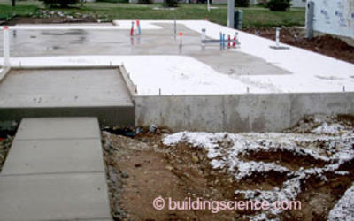

Photograph 5 is one of my all time favorite images. Look at the snow melt pattern outlining the under slab insulation. I call this a “poor persons infrared thermograph.”
Photograph 5: Poor Persons Infrared
—Look at the snow melt pattern outlining the under slab insulation.

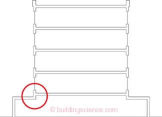

So what do you do if your slab is in the middle of the air and unconditioned underneath and sticking out all over? That, my friends, is Figure 5 – a very, very common way of building apartments and condos today. Think parking garage underneath that’s the unconditioned part. The red marks the spot. Well you can only insulate these things on the top or on the bottom. None are fun if you are serious about the thermal bridge caused by the slab sticking out horizontally “all over.”
Figure 5: Elevated Slab
—Common way of building apartments and condos with a parking garage underneath that is unconditioned. The red marks the spot. You can only insulate on the top or on the bottom. None are fun if you are serious about the thermal bridge caused by the slab sticking out horizontally “all over.”
