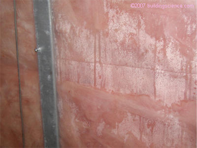

Photo_01: Interior poly
Photograph 1:
Interior Polyethylene Vapor Barrier – Condensation from inwardly driven moisture

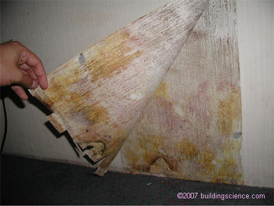

Photo_02: Vinyl wallcovering
Photograph 2:  Vinyl Wallcovering – Mold due to inwardly driven moisture trapped by the vapor impermeability of the vinyl wallcovering
In this example the water started out as a liquid governed by gravity (the rain on the brick veneer) and was pulled into the porous brick veneer by capillarity. It was driven from the brick veneer and converted into a vapor in the airspace behind the brick by the energy added by the incident solar radiation [3]. Once in the cavity it traveled along the concentration gradient and thermal gradient through the wall assembly materials by the process of vapor diffusion until it condensed back into a liquid at the interior of the exterior wall assembly. Once in the liquid form again, it ran down the wall to the bottom plate. Two rules can prevent this common problem sequence:
Rule Number One:  Never install a vapor barrier on the inside of a wall assembly, which has a moisture reservoir cladding and a vapor permeable combination of sheathing and building paper.

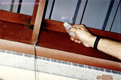

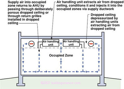

Let’s stay with the rain on the brick veneer over a cavity thing a little longer. Assume that same building is equipped with a dropped ceiling return air plenum (Figure 2). A return plenum operates under a negative air pressure. It’s not likely that the interior gypsum board extends to the underside of the roof/floor assembly and is sealed with a material that is airtight. The usual practice is to shove some mineral wool in the flutes or floor decking above the top of the gypsum board and hope for the best.
Figure_02: Dropped ceiling
Figure 2:  Dropped Ceiling Return Plenum
Given the poor air seal, the negative pressure in the ceiling plenum sucks saturated air out of the wall cavity into the plenum (Photograph 3) where it can condense on piping, ductwork and anything else it contacts that has a surface temperature below its dewpoint (Figure 3). We don’t even need the brick veneer to be saturated to cause this type of a problem. We don’t even need brick – any cladding will do. All we need is outside air to have a dewpoint temperature above the temperature of any surface inside the interior space. Actually, we don’t even need that. Anything that leads to a relative humidity at a hygroscopic surface above 80 percent will do just fine for mold growth. It is alarmingly common to have the de facto fresh air intake of many buildings be the underside of the parapet flashing (Photograph 4).

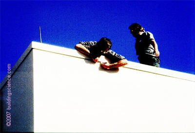

Photograph 4:  Parapet Fresh Air Intake

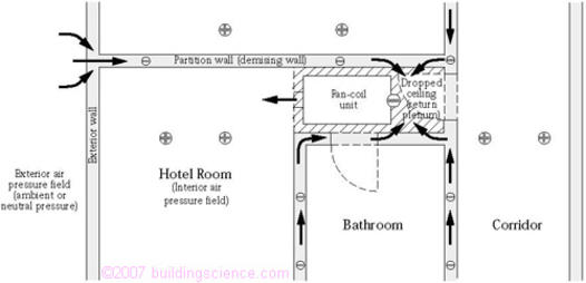

This “sucking on the exterior wall” trick can be accomplished many ways. We don’t always need a dropped ceiling return plenum. We can sometimes just use an interior wall that thinks it’s a duct [4]. The hotel industry and nursing homes are famous for this type of problem. When we couple this with vinyl wall coverings even on interior walls mold grows behind the vinyl. Fan coil units are often enclosed in less than airtight gypsum board enclosures (Photograph 5) and rooftop exhaust fan systems rarely employ airtight ductwork or airtight shafts. The negative pressure fields developed by suction from these fans can extend to exterior walls, drawing air out of exterior cavities inward (Figure 4 and Figure 5).

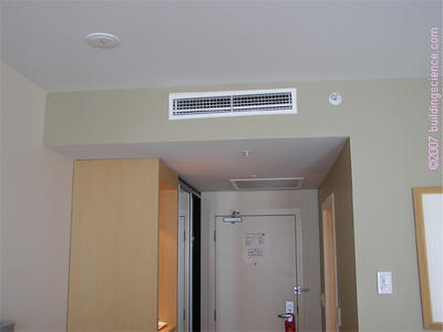

Photo_05: Fan-coil AHU
Photograph 5:
Fan Coil – Air handler in gypsum board dropped ceiling enclosure
Figure_04: Pressure fieldFigure 4:  Pressure Field Due to Fan Coil Unit (Plan View)

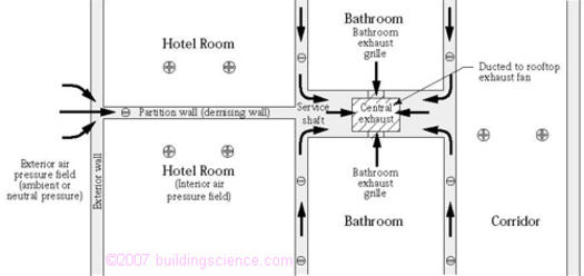

Figure_05: Pressure fieldFigure 5:  Pressure Field Due to Central Exhaust (Plan View)
In this example the water is pulled out of the cavity or from the exterior ambient air in the vapor form. It is transported by air moving from a higher air pressure to a lower air pressure until it contacts a cool surface where it converts back into a liquid and causes mischief.
Rule number three prevents this problem: Never suck on the exterior building enclosure with your mechanical system. Do not connect drop ceiling return plenums to exterior walls. Make sure that intersecting interior walls neither contain nor are connected to leaking return ductwork or to any leaking exhaust chases or ducts and make sure that all return ducts are sealed tightly with mastic on all joints.

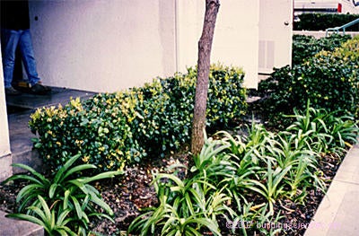

All too frequently we can create a water problem in the middle of a desert. There are many variations. Consider foundations.  Normally, we do not have to worry about ground water in the desert. But, let’s plant shrubbery beside a concrete foundation slab. Since we have very little rain, let’s irrigate the plantings so that the ground beside the foundation becomes saturated (Photograph 6). The water then wicks into the porous concrete from the saturated ground by capillary suction.  Then it moves upward into the wall assembly (Figure 6). The symptoms are a musty odor inside and if the wall is opened, the bottom plate is typically saturated (Photograph 7).
Photo_06: Swamp in the desert
Photograph 6:
“Swamp In Desert” Cleverly Located Beside Building Foundation Perimeter
Figure_06: Slab edge capillarity
Figure 6:
Slab Edge Capillarity

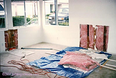

Photo_07: Wet bottom plate
Photograph 7:
Wet Bottom Plate – Mold and odors due to capillary rise
This is a fairly simple problem to diagnose and fix. Stop the water. Kill the plants. Or move the plants well away from the foundation perimeter so that when they are irrigated, the saturated ground is not in contact with the foundation. Install a capillary break under the bottom plate of the wall to separate the wood from the wet concrete. Finally, damp proof the edge of the slab with an acrylic latex paint or some other damp proofing material.
The symptoms of this problem can get more complicated with the installation of an impermeable vinyl floor cover or tile flooring. The water can be wicked inwards laterally from the foundation perimeter leading to discoloration of the flooring and loss of adhesion of the flooring. In some cases, the lateral wicking can be many feet. Then the problem is manifested in mold under kitchen cabinets located in “islands” far away from slab foundation perimeters.  Water problems in the middle of slab foundations can be due to a water source at the building perimeter as a result of this lateral capillary movement of water. But the solution to the problem is the same – keep moisture from entering the slab by using capillary breaks and by reducing the amount of water soaking the soil near the edge of the foundation.

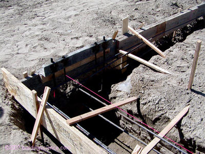

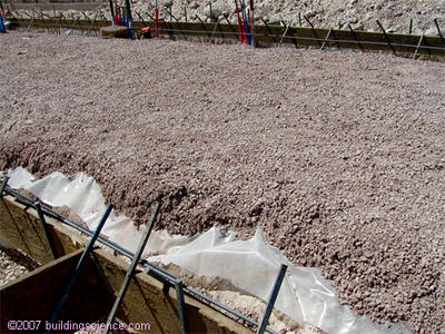

Now on to a very odd and clearly bad practice that has sometimes even been established in building codes. It is common, west of the Mississippi, to place slab foundations over a sand layer installed over a polyethylene vapor barrier (Photograph 8 and Photograph 9). You rarely see this east of the Mississippi.
Photo_08: Sand on poly
Photograph 8:  Sand On Top of Polyethylene – Note polyethylene does not extend to perimeter
Photo_09: Layers on poly
Photograph 9:  Madness In The Desert:  Note granular layer on top of polyethylene

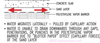

The sand layer becomes a reservoir for water in the liquid state that enters the sand layer by gravity flow from the top, sides and bottom (Figure 7). Where does this liquid water come from?  We often wet cure these slabs. We wet them from the top with sprinklers; we sometimes even pond water on top of them. We often over-irrigate perimeter plantings (see above). Plumbing pipes leak. Even in the desert it sometimes rains during construction. The sources of liquid water are many. The liquid water that inevitably finds its way into the sand layer is both held in the sand layer and redistributed within the sand layer by capillarity (Figure 8). Additionally, due to capillary suction, the liquid water cannot drain out of the sand layer. The only mechanism of drying of the sand layer is upwards through the concrete slab by vapor diffusion (Figure 9).

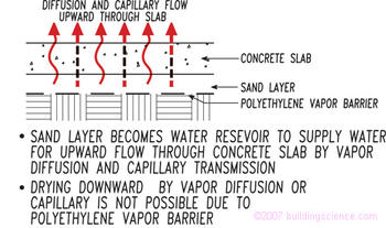

Moisture diffuses upwards through the top surface of the concrete slab as well as through floor surface treatments and leads to mold and other microbial contamination problems.
The rate of wetting of the sand layer by the gravity flow liquid water wetting mechanism is several orders of magnitude greater then the rate of drying of the sand layer by the vapor diffusion drying mechanism. The sand layer becomes a water reservoir that continually supplies water for the upward flow through the concrete slab by vapor diffusion. A couple of hours of liquid water gravity wetting yields a couple of years of diffusion drying.
Picture the sand layer as “blotter paper” that once wetted does not let water drain out of it. The only method of drying available to the “blotter paper” is evaporation. In the case of the sand layer the only method of “evaporation” is upwards through the concrete slab due to the presence of the polyethylene vapor barrier under the sand layer.

In this example the water enters the sand layer under the slab in the liquid form by gravity. The water is redistributed in the sand layer by capillarity and migrates upward by vapor diffusion.
This leads to rule number four:  Never place concrete on a sand layer installed over a polyethylene vapor barrier. Always place concrete in direct contact with plastic vapor barriers. Use a low water-to-cement ratio concrete, less than 0.45, and top cure the slab with damp burlap, just like the old wise concrete types used to.
