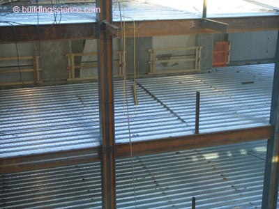

Photograph 6: Fluted Steel Deck—We seem to be able to place concrete slabs on fluted steel decks without needing a sand layer to control curl.
Okay, so we don’t need the sand layer to handle the “curl” thing. But what about using the sand layer to protect the polyethylene? Hah. The polyethylene does not need protecting. You can poke holes in it, you can puncture it, you can tear it, you can leave gaps in it, and pretty much have your way with it as long as it is in direct contact with the concrete. Huh? But, but, vapor barriers have to be continuous and free from any holes. Actually, no. Air barriers need to be continuous and free from holes, but vapor barriers do not need to be. Lots of vapor moves by air movement, not a heck of a lot of vapor moves by vapor diffusion. The concrete slab is the air barrier, and the ripped and torn and punctured polyethylene sheet is the vapor barrier. It’s that Fick’s Law thing. Diffusion is a direct function of surface area—if I get 95 percent of the surface covered I am pretty much 95 percent effective—and the parts that are left I have filled with concrete which is also pretty good as a vapor barrier. I could wear golf shoes and march around the plastic vapor barrier and not do much damage. But put that sand layer in there and you are doomed.

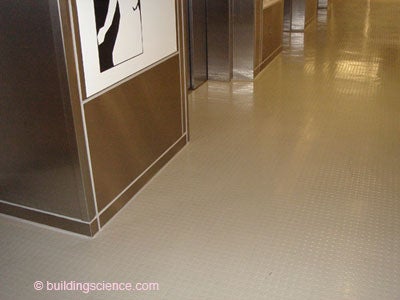

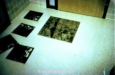

Even new assemblies get into trouble – specifically vinyl composition flooring (Photograph 8 and Photograph 9). When these types of highly impermeable flooring systems are installed over concrete slabs cast over steel fluted decks high alkalinity at flooring slab interfaces can cause debonding of the flooring. The best strategy is to coat the top of the concrete slab with an epoxy coating prior to the installation of the flooring. Alternatively, don’t use fluted steel decks—use removable forms so that the slab can dry downwards—obviously not a solution for slab-on-grade construction.
Photograph 8: Vinyl Composition Flooring—The best strategy is to coat the top of the concrete slab with an epoxy coating prior to the installation of the flooring. Waiting for the slab to dry is typically not an option as this may take a year or more. Alternatively, don’t use fluted steel decks—use removable forms so that the slab can dry downwards—obviously not a solution for slab-on-grade construction.
Photograph 9: Failing Vinyl Composition Flooring—When these types of highly impermeable flooring systems are installed over concrete slabs cast over steel fluted decks high alkalinity at flooring slab interfaces can cause de-bonding of the flooring.
