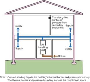

  • Ducts in conditioned space - This building profile is designed to accommodate HVAC equipment and ducts in the living space. Specifically, the duct system is a blow up/blow down configuration located in either the second floor framing or an extensive network of dropped soffits. Use of advanced framing and opened web floor trusses is a good fit here, with the duct system in the floor trusses. Click here for more information.

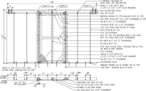

  • Advanced framing – This wall assembly employs all of the advanced framing methods, including structural bracing rather than sheathing on the first floor. For advanced framing details, see Using Wood Efficiently. For information on the inset shear panel developed for a comprehensive approach to advanced framing in seismic regions, see Figure 11 and Design Guidance for Inset Wood Shear Panels.

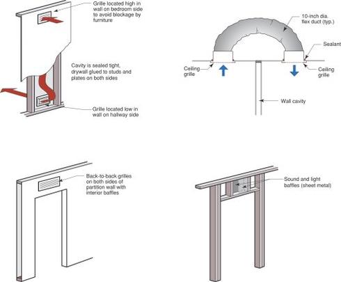

  • Ducting - Single return requires transfer grilles to provide path and avoid pressurizing bedrooms, as shown in the figures at right. Appropriate sizing for ducts, including these pressure relief methods, can be found see Figures 12a-d or go to System Sizing.
Figure 12a-d

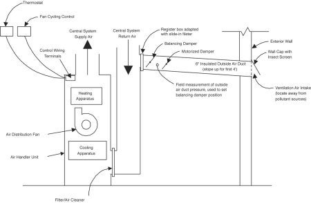

  • Controlled mechanical ventilation - Intermittent central-fan-integrated supply, designed to ASHRAE 62.2P rate, with fan cycling controls set to operate the central air handler as much as 33% of the time, but not less than 25 % of the time, occurring within at least every three hours to provide ventilation air distribution and whole-house averaging of air quality and comfort conditions (installed cost: $125 to $150). Include a normally-closed motorized damper in the outside duct with the AirCycler® FRV control (installed cost: $50 to $60). See Figures 13, 14 and 15.
    Figure 13

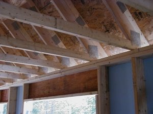

  • Energy trusses – There are a number of different truss configurations that yield greater depth at the heel, but they vary quite a bit in cost. The truss shown in Figure 16 (sometimes called a “slider” truss) has proven to be among the most cost-competitive. And of course, the pitch of the roof affects just how much insulation you can get at this location, regardless of the type of truss.

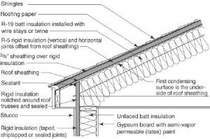

  • Single story homes and unvented/conditioned attics – Keeping all ducts and HVAC equipment in conditioned space with slab-on-grade, single story homes can be accomplished by moving the thermal barrier and air barrier up to the roof line, making the attic an unvented, conditioned space. Below are the associated building science points to consider when making the change to an unvented roof/conditioned attic:
    • Air sealing details – Unvented assemblies — walls or roofs — are robust when the air sealing is robust. The hardest spots are not the fields but the margins/edges of assemblies. Spray foam applied at the margins (truss/rafter end blocking) may seem more expensive than cutting in air stops and caulking between each truss or rafter, but the labor savings and air sealing quality of spray foam are clear.
    • Cavity insulation - Cellulose netting or fiberglass batt supports create the insulation “belly” and accommodate cavity fill depth that exceeds the depth of the truss top chord.
    • Local acceptance - This assembly may require discussion with the local building code official. See our Unvented Roof Summary Article for assistance.
    • HVAC configuration – See Figure 15 Interior Closet Configuration for the basic HVAC setup in this structure.
    • Moving this assembly to Mixed-Dry Climates – If an unvented roof/conditioned attic assembly is employed where the coldest monthly average temperature drops below 45°F, we recommend that a rigid insulation be added exterior to the structural roof deck to warm the assembly to the interior of the rigid insulation, thereby reducing the potential for condensation problems in the structural roof deck. See Figure 18 and the following technical resource for more information: “Insulations, Sheathings, and Vapor Diffusion Retarders.
