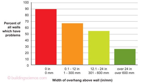

The shape of the roof and overhangs also have a critical impact. Field measurements [1] and computer modelling [2] have shown that overhangs and peaked roofs reduce rain deposition by approximately 50%.  A damage survey of wood frame buildings in British Columbia [3] found that the size of a buildings overhang correlated directly with the probability of rain-related damage (Figure 1).
Figure 1: Wall problems as a function of the overhang size from a field survey.

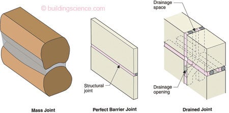

Joints between the wall and penetrating items or between joints within components (such as between the window frame and glazing) can use any one of the three strategies applied to walls (Figure 9). Joints are often designed as face-sealed perfect barrier elements made of sealant. These joints have a very high chance of failure, and may defeat the otherwise good performance of a drained or storage wall system. They are not recommended.

Figure 9: Three rain control strategies applied to joints.
Flashing must be made of a waterproof material (such as PVC, metal, or peel and stick membranes, not building paper or housewrap) since it is installed in a nearly horizontal manner [17]. Flashing must be installed in a continuous manner with an outward slope. Leaks often occur at lapped joints between lengths of rigid flashing, so these should be sealed, not just lapped.
Windows and especially mulled window joints and window corners often leak rainwater into the wall.  To deal with this eventuality (some would say likelihood), sub-sill flashing should be installed.  Essentially, the rough window should be prepared in such a way as to make it water resistant. The head of window should also be protected with flashing that directs surface rainwater away from the window and the window opening. This flashing directs water on the surface of the cladding and in the drainage gap safely outward. Head flashing and window sills should extend past the window jambs by at least 2” (50 mm) so that water flowing laterally on the flashing does not concentrate at the jamb but is directed away and dripped clear of the face of the cladding.
