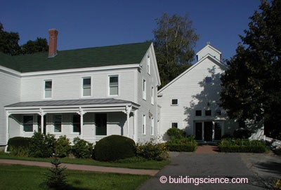

Check out the house in Photograph 1. Built in 1880 on top of a rubble foundation. It was a dump. Every time it rained the basement flooded. And it wasn’t really a basement. It was sort of a tall crawlspace with a short crawlspace attached to one side. The house smelled. It smelled bad. Moldy, musty, and dirt-like. The floors were freezing in the winter. During cold weather it was not possible to keep the basement door closed because of the draft rushing up from purgatory. In other words it was the perfect house for us so we bought it–yup, my bride and I live in this house.
Photograph 1: Looks Good Now—You should have seen this place when the timber frame was rotting and the basement was smelly and the rubble foundation was leaking and the floors were freezing.

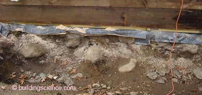

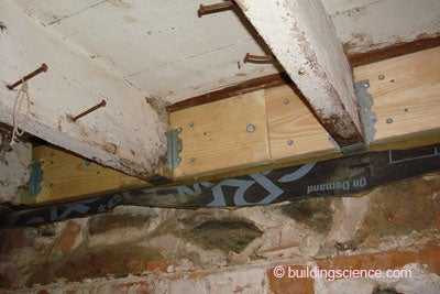

The entire house was then lifted 1 inch in order to insert a sheet plastic butyl membrane capillary break (Photograph 3). And then the house was set back down. This is not as hard as it seems. In fact it is pretty straightforward. Small 10 ton hydraulic jacks were used with steel angle iron brackets that were lag bolted into the perimeter foundation wood member. We used 5 jacks rented from the local hardware store–three on the outside approximately 10 to 12 feet apart and two on the inside at the lifting mid points to keep the timber rim beam from rotating.5
Photograph 3: Disbelieving Neighbor—Yes, you can actually lift a house off its foundation a section at a time with small hydraulic jacks and steel angles lag bolted into the bottom of the timber frame. We used 5 jacks rented from the local hardware store–three on the outside approximately 10 to 12 feet apart and two on the inside at the lifting mid points to keep the timber rim beam from rotating. A membrane capillary break was installed between the top of the rubble wall and the timber frame.

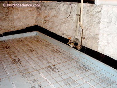

Photograph 4: Foam Bathtub—Extruded polystyrene foam on top of a gravel layer on top of the existing combination dirt and broken concrete slab floor. The perimeter drain was located in the space between the foam “bathtub” and the perimeter foundation wall in the granular layer perimeter drainage zone. A new concrete slab was cast inside the foam “bathtub.”

Next came the interior perimeter drain (Photograph 4). We installed a foam “bathtub” on top of gravel layer on top of the existing combination dirt and broken concrete slab floor. This foam “bathtub” did not extend to the inside perimeter of the foundation. The perimeter drain was located in the space between the foam “bathtub” and the perimeter foundation wall. A new concrete slab was cast inside the foam “bathtub.” A sheet polyethylene butyl composite membrane lining was installed covering the interior perimeter rubble foundation wall and the upper short crawlspace floor (Photograph 5). This membrane lining was sealed to the capillary break that was installed on the top of the rubble foundation under the timber frame and also sealed to the new concrete slab cast inside the foam “bathtub.” The perimeter foundation drain and sub foam gravel layer was connected to an airtight sump crock. The sump crock contained a pump that expelled water to the exterior above grade (hidden behind bushes so as not to attract the attention of a bunch of loonie tunes you have already been briefed about).

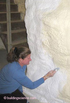

Photograph 8: Intumescent Coating—A liquid applied ignition barrier is recommended as minimum protection for exposed spray foam. I think that perhaps a bigger brush would have made it go faster – just a thought.

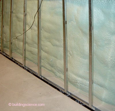

The interior surface of the membrane lining was insulated with direct spray applied polyurethane foam – the high density closed cell stuff (Photograph 6). The slab was subsequently painted to make it look pretty (Photograph 7). A liquid applied ignition barrier–an intumescent coating is recommended (it is now a code requirement) and will eventually be applied (Photograph 8).6

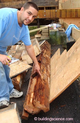

Many rubble foundations do not project much above grade. The installation of a robust capillary break is a necessity along with lowering the immediate adjacent grade (Photograph 10). Many of the bearing timbers typically have to be replaced due to serious rot (Photograph 11) and the sills have to be rebuilt (Photograph 12). These are not options, especially when insulation is added from the interior. Energy and airflow is no longer going to be available to assist in drying. Wetting from underneath needs to be eliminated and wetting from the outside needs to be controlled–exterior drainage planes and back ventilated claddings–or at minimum a back-ventilated “water table” trim detail. Tell the Historical Commission that Grandma heard her Grandma say that the house used to have one.
Photograph 10: Capillary Break Critical—Many rubble foundations do not project much above grade. The installation of a robust capillary break is a necessity along with lowering the immediate adjacent grade.
Photograph 11: Rotted Bearing Timbers—Many of the bearing timbers typically have to be replaced due to serious rot.
Photograph 12: Rebuilding Sill Assembly—Bolts and hangers and more bolts and hangers and still more…

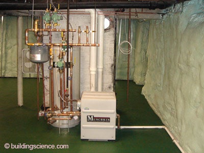

The foam lining makes for a very nice home for some very happy mechanical equipment (Photograph 15). This equipment is best when it is sealed combustion and power vented as the old air leaky foundation is now pretty much airtight. As nice as the foam is to look at–notice the green color chosen for the concrete floor coating and the green tint to the foam itself–obviously very environmental–it really should be protected from mechanical damage and from ignition sources. That’s where thin lightweight steel framing and gypsum board are ideal (Photograph 16 and Photograph 17).
Rubble is no longer rubbish. A lemon is turned into lemonade. And oh yes, energy is saved.
Photograph 15: Mechanical Equipment—Very nice home for some very happy mechanical equipment. This equipment is best when it is sealed combustion and power vented as the old air leaky foundation is now pretty much airtight.

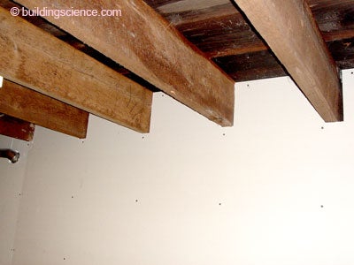

Photograph 16: Protection for Insulation Layer—As nice as the foam is to look at it really should be protected from mechanical damage and from ignition sources. That’s where thin lightweight steel framing and gypsum board are ideal.
Photograph 17: Gypsum Board Protection Layer—Gypsum is made from a type of rock–and rocks don’t burn–this is a good thing.
