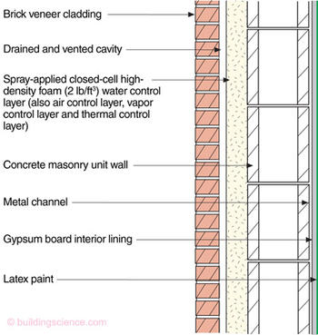

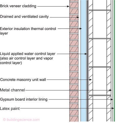

For example a liquid applied water control layer can also be the assembly air control layer and vapor control layer (Figure 1). In some assemblies closed cell high-density (2 lb/ft3) spray polyurethane foam can be the assembly water control layer, air control layer, vapor control layer and also thermal control layer (Figure 2).
Figure 1: Institutional Wall
– Combined water control layer, air control layer and vapor control layer in single material. The thermal control layer is located exterior to the other control layers.

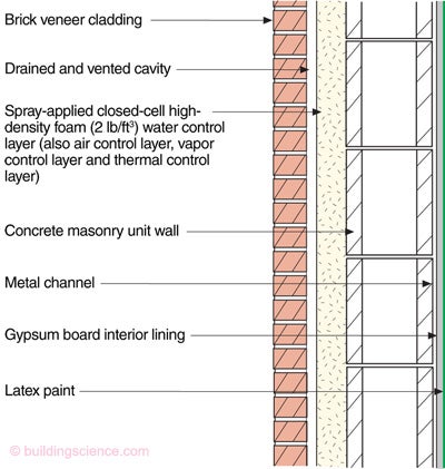

Figure 2: Spray Foam Wall
– Water control layer, air control layer, vapor control layer and thermal control layer combined in one material. Key to make a building work is the connection between the field of the wall and punched openings such as window glazing and connections to roof assemblies. But that discussion is for another day.

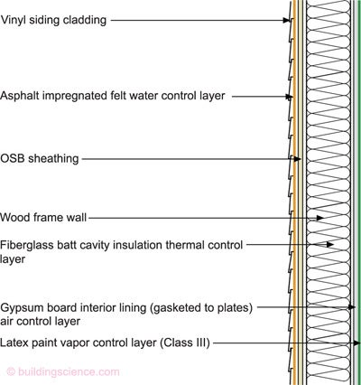

In a typical residential example shingle lapped asphalt saturated kraft paper or asphalt impregnated felt is the assembly water control layer. The fiberglass batt cavity insulation is the assembly thermal control layer. The glued and gasketed gypsum board is the assembly air control layer and the paint on the interior surface of the gypsum board is the assembly vapor control layer (Figure 3).
Figure 3: Residential Wall
– The water control layer is on the outside. The air control layer and vapor control layer are on the inside. The thermal control layer is in the middle.

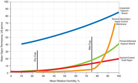

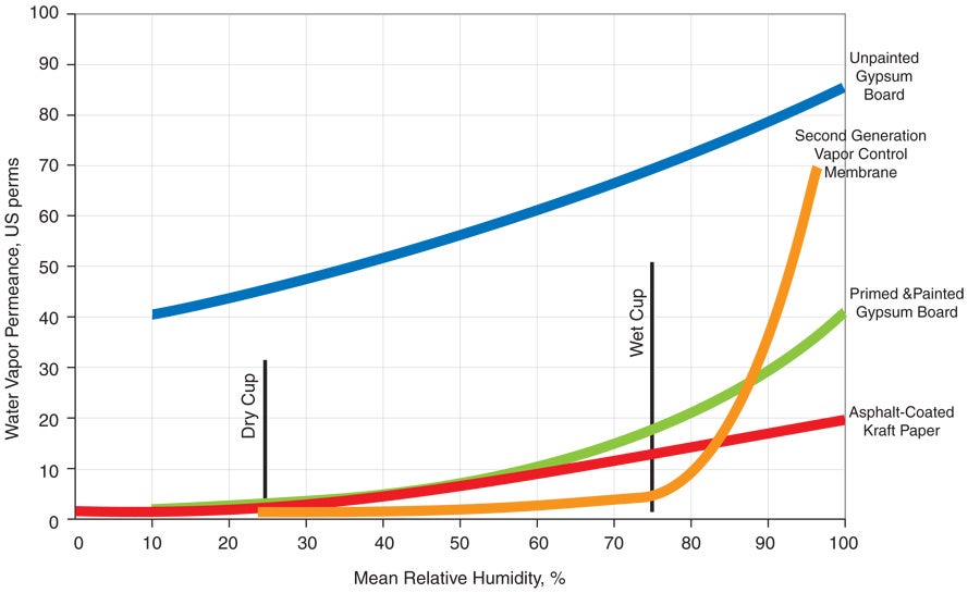

Figure A: The traditional “vapor barrier” on a fiberglass batt is actually “asphalt-coated kraft paper” that varies in vapor permeance as a function of relative humidity. It pretty much is a vapor barrier only in the absence of vapor. It really functions much like a valve that opens and closes depending on available moisture. In the winter in most older homes the interior relative humidity is in the 20 percent range whereas in the summer the interior relative humidity is in the 50 percent to 60 percent range. So in the winter a kraft-faced batt has a vapor resistance of approximately 1 perm—an interior vapor retarder on the correct side of the thermal control layer—reducing outward vapor flow. And in the summer the same kraft faced batt has a vapor resistance of approximately 10 perms—allowing the same assembly to dry inwards. It is interesting to note that latex painted gypsum board works pretty much the same way. And now we have new “smart materials” that are engineered to take advantage of the differences (2nd Generation Vapor Control Membrane).
