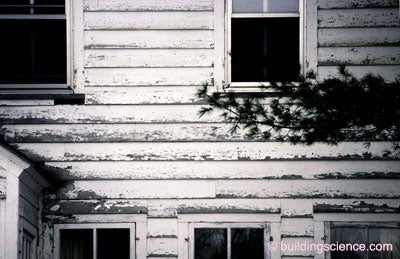

It gets worse with paint films on the south and west side of buildings. Wood claddings move more on the south and west side because they go through greater temperature differences which lead to greater relative humidity differences which lead to greater moisture content differences. The biggest stresses on the paint films also happen on the orientations where they get the most brittle. Paint tends to fail on south and west orientations more because of greater solar exposure and greater substrate movement (Photograph 1).
Photograph 1: Painted Wood Siding
—Wood claddings move more on the south and west side because they go through greater temperature differences which lead to greater relative humidity differences which lead to greater moisture content differences. The biggest stresses on the paint films also happen on the orientations where they get the most brittle. Paint tends to fail on south and west orientations more because of greater solar exposure and greater substrate movement. Notice that the bottom edges loose the paint first. Old guys noticed this as well hence the practice of back priming at the overlaps. This is old siding with old paint – the non elastic non vapor permeable stuff – alkyd paint. Modern paints don’t do this. Having said that, it is still a good idea to back prime wood siding and back ventilate it by installing it over furring even when using the new stuff.

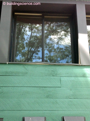

Photograph 3:  Hardboard Siding Getting Thicker
—The thickening happens first at the bottom edges of the boards at the overlap. It was often called “brooming” after the bristles of a broom that flair out at the bottom. It was as if the wood was trying to get back to its original density.

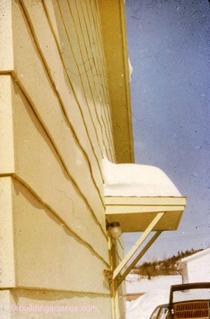

Photograph 4: Hardboard Shingles
—Yes, folks tried to make shingles out of hardboard.

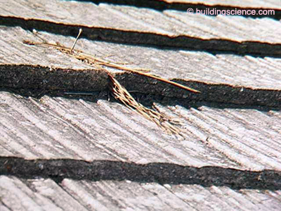

Photograph 5: OSB Edge Swell
—Notice the swelling at the edges of the OSB sheet subflooring. The good stuff has a lot more rubber bands than the bad stuff. This is not good stuff. With sheet OSB it became pretty clear that edges were where the action was. A lot of design and trial and error went into the design of OSB edges to protect them from edge swell. I don’t know of a builder that hasn’t experienced this. The good news is that it does not have to happen. You can get OSB that does not do this. Of course you get what you pay for.

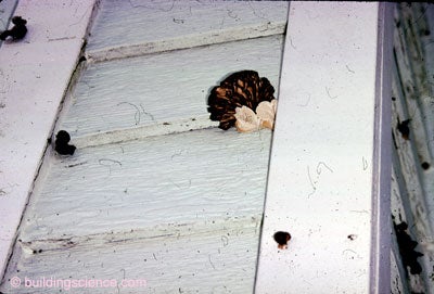

Photograph 6: The “Wolfgang Puck” Effect
—Yes, those are mushrooms growing out of OSB siding made in the 1990’s – they might even be edible. Notice the thickening at the bottom edges of the boards at the overlap causing the paint film to fracture allowing even more water uptake via capillarity at the bottom edges.
Can OSB siding work? Yes, but be careful. The wood industry finally figured out how to make hardboard siding work, unfortunately too late for most of the industry, and is figuring out how to make OSB siding work. OSB siding requires lots of rubber bands and magic. And back ventilation and drainage and luck.

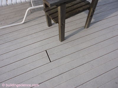

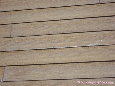

Photograph 8: Plastic Decking
—Use shorter pieces to make the gaps smaller. But no matter what you are going to get gaps
