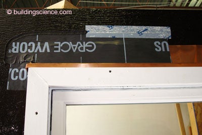

At penetrations such as windows and doors (Figure 1) we have learned to “scrape the water off the sheathing at the tops of the windows by taping the top flange of the window directly to the sheathing under the building wrap (Figure 2). This is a big deal. If we didn’t do this the water running behind the building wrap would wet the top of the window opening interior finish and folks would see it. We don’t care if this water leaks through a joint in the sheathing in the field of the wall because the wet spot isn’t seen by anyone. And if the wall is designed to dry either to the interior or exterior or both it does not matter anyway.3 Recall, that this amount of water is small.
Figure 1: Water Entry at Window Opening
 (left) – It is important to address water running behind building wraps and housewraps at window heads and the sides of window openings.
Figure 2: Control of Water at Window Head (right) – The top window flange is taped directly to the sheathing with “flashing tape”. Note how the building wrap or housewrap is cut and folded upwards to expose the sheathing so that the “flashing tape” can be installed. Once the tape is installed, the flap is folded back down. This works exceptionally well.

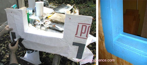

Photograph 3: Formable Flashing (above left) – Life got better when flashing systems became formable and flexible. This photo dates back a decade to when I got my first sample of flexible flashing to play with in my back yard. I thought it was the greatest invention since the transistor. Ok, so I am exaggerating - but only a little. Look at how beautifully a seamless under window flashing system is created.
Photograph 4: No Origami Here (above right) – Today’s liquid applied systems easily handle complex geometries seamlessly.

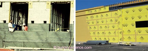

In commercial and institutional buildings we have come to rely on fully adhered membranes and liquid applied membranes (Photograph 5 and Photograph 6). By adhering directly to the sheathing the wind load issues become moot. And with no gap between the water control layer and sheathing we don’t have to worry about water that enters through fasteners wandering around between the two layers. But we had to learn a great deal about how to get the membranes to “stick”. We found we had to “prime” concrete and masonry block surfaces to get things to stick. And when we had “reverse laps” we had figure out a way to “terminate” the lap - otherwise it would “fishmouth” and begin to peel away. In the early years it was so bad we used to call “peel and stick” membranes “stick and peels”. When these products were first introduced in commercial buildings they had horrible reputations. Now they are the gold standard. But it took almost 20 years and major advances in adhesive technology.
Photograph 5: Fully Adhered Membrane
(above left) - In commercial and institutional buildings fully adhered membranes are the “gold standard”. But it took 20 years. These are now true “peel and stick” systems when primers are used.
Photograph 6: Liquid Applied Membrane (above right) - Becoming common now. Note the joint treatment – a tape reinforced mastic is installed at the joints first – then over coated with a liquid applied membrane creating as seamless, jointless system.

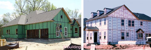

Residentially we now use tapes on wood sheathings (Photograph 8) and foam sheathings (Photograph 9) to provide water management and air management. So how well do these systems actually work? Now? Real well. In the early days? Not so good. The residential tape systems had to go through the same learning curve the commercial membrane systems went through.5
Photograph 8: Wood Sheathing
(above left) - Residentially we now use tapes on wood sheathings that have factory applied membranes factory bonded to them to provide water management and air management.
Photograph 9: Foam Sheathing (above right) - Foam plastic sheathing panels are taped together creating a water-resistive barrier system. These systems are now around 20 years old. This image dates back to a subdivision development in Chicago in 1995. 3M was one of the first to develop acrylic based tape system for housewraps in the 1980’s and they migrated to foam sheathings in the 1990’s.

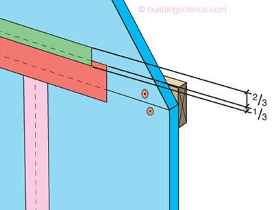

Back to this termination thing. With flashing tapes we tend to terminate them two ways – with either a sheathing tape or a bead of sealant (Photograph 14 and Figure 4). A sheathing tape does not need to be terminated – it terminates itself.
Photograph 14: More Termination (above left)
- With flashing tapes we tend to terminate them two ways – with either a sheathing tape or a bead of sealant. A sheathing tape does not need to be terminated – it terminates itself.
Figure 4: Termination of Flashing Tape (above right) – The “red” horizontal tape is a butyl based “flashing tape” that is “terminated” by a “green” acrylic based “sheathing tape.”

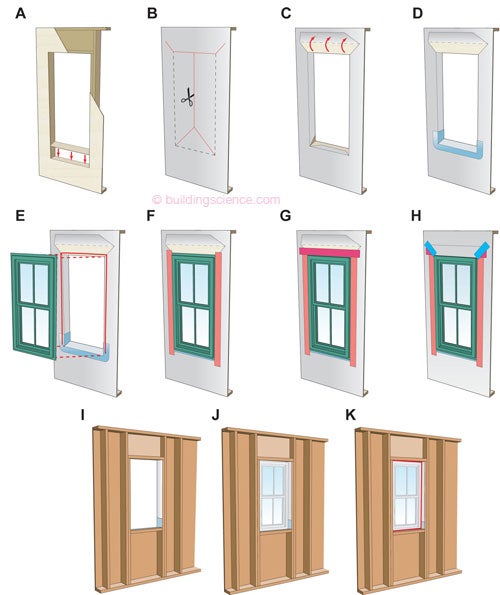

Sidebar I: Installing Windows in Housewrap Openings
A) Install beveled wood siding in frame wall opening at sill to create slope; (B) “I” cut in housewrap; (C) Fold housewrap in at jambs and sill; housewrap at head temporarily folded up; (D) Install formable flashing at sill; (E) Install sealant bead at head and jambs; install window plumb, level and square; (F) Install flashing tape at jambs; (G) Install flashing tape at head; (H) Fold housewrap down at head; tape in place with sheathing tape; (I) Interior view prior to window installation; (J) Interior view after window installation; (K) Air seal window around entire perimeter on interior with sealant and sealant backer rod

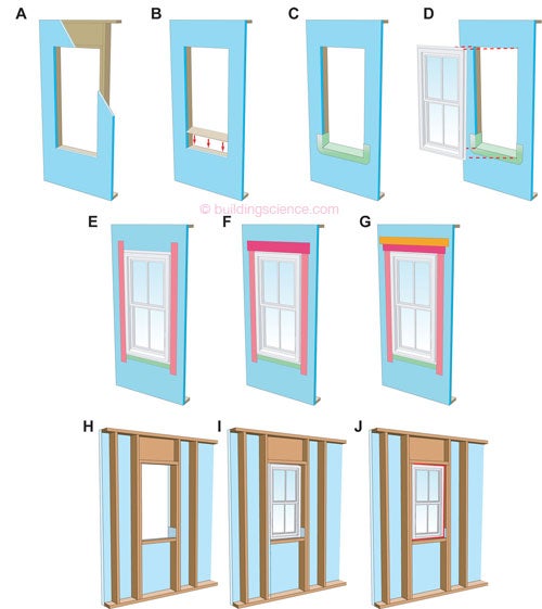

Sidebar II: Installing Windows in Insulating Sheathing Openings
(A) Insulating sheathing installed over frame wall; (B) Install beveled wood siding in frame wall opening at sill to create slope; (C) Install formable flashing at sill; (D) Install window plumb, level and square; (E) Install flashing tape at jambs; (F) Install flashing tape at head; (G) Install sheathing tape over flashing tape at head to terminate flashing tape; (H) Interior view prior to window installation; (I) Interior view after window installation; (I) Air seal window around entire perimeter on interior with sealant and sealant backer rod
