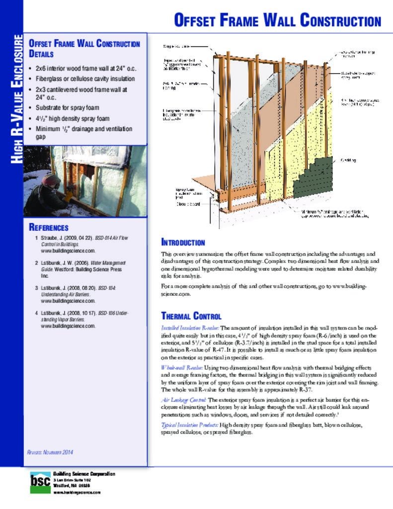

This overview summarizes the offset frame wall construction including the advantages and disadvantages of this construction strategy. Complex two dimensional heat flow analysis and one dimensional hygrothermal modeling were used to determine moisture related durability risks for analysis.
  • Cladding
  • Minimum 1/2"  drainage and ventilation
  • 2x3 cantilevered wood frame wall at 24" o.c.
  • 4 1/2" high density spray foam
  • Substrate to support spray foam
  • 2x6 interior wood frame wall at 24" o.c. with fiberglass or cellulose cavity insulation

Installed insulation R-value: The amount of insulation installed in this wall system can be modified quite easily but in this case, 41/2” of high density spray foam (R-6/inch) is used on the exterior, and 51/2” of cellulose (R-3.7/inch) is installed in the stud space for a total installed insulation R-value of R-47. It is possible to install as much or as little spray foam insulation on the exterior as practical in specific cases.
Whole-wall R-valueUsing two-dimensional heat flow analysis with thermal bridging effects and average framing factors, the thermal bridging in this wall system is significantly reduced by the uniform layer of spray foam over the exterior covering the rim joist and wall framing. The whole wall R-value for this assembly is approximately R-37.
Air Leakage Control: The exterior spray foam insulation is a perfect air barrier for this enclosure eliminating heat losses by air leakage through the wall. Air still could leak around penetrations such as windows, doors, and services if not detailed correctly.1
