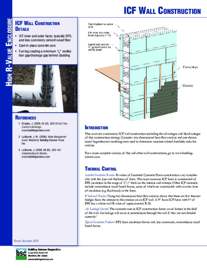

This overview summarizes ICF wall construction including the advantages and disadvantages of this construction strategy. Complex two dimensional heat flow analysis and one dimensional hygrothermal modeling were used to determine moisture related durability risks for analysis.
  • Cladding
  • Furring strips creating a minimum 3/8" ventilation gap/drainage gap behind cladding
  • Cast-in-place concrete core with ICF inner and outer faces; typically EPS, and less commonly cement wood fiber
  • Interior gypsum wall board
Thermal Control
Installed insulation R-value: R-values of Insulated Concrete Form construction vary considerably with the type and thickness of form. The most common ICF form is constructed of EPS insulation in the range of 21/2” thick on the interior and exterior. Other ICF materials include cementitious wood based forms, some of which are constructed with an extra layer of insulation (e.g. Rockwool) in the form.
Whole-wall R-value: Using two-dimensional heat flow analysis shows that there are few thermal bridges from the interior to the exterior on an ICF wall. A 9” foam ICF form with 5” of EPS has a whole-wall R-value of approximately R-20.
Air Leakage Control: he concrete core in ICF construction forms an air barrier in the field of the wall. Air leakage will occur at penetrations through the wall if they are not detailed correctly.1
Typical Insulation: EPS foam insulation forms and, less commonly, cementitious wood based forms.

ICF construction is a very durable construction strategy provided the rainwater management details are constructed correctly. Generally, ICF construction alone cannot achieve a high R-value and will require other insulation strategies in combination for cold climates, which is commonly done in practice. ICFs are ideal for basements and multi-story residential and are being adopted as the dominant choice in some markets.
