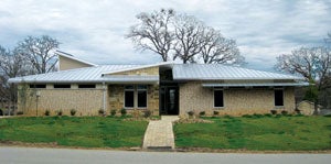

BSC collaborated with Greencraft Builders in Lewisville, TX on a 2009 prototype house called the TimberCreek Net Zero Energy House. This house demonstrates the energy efficiency and durability upgrades that Greencraft has been promoting for years. The architect for the TimberCreek Net Zero Energy House was William Peck and Associates, out of Lewisville, TX. The TimberCreek Net Zero Energy House is located in Lewisville, TX.
Project Team: Greencraft Builders, LLC, Building Science Corporation
Location: Lewisville, Texas
Description: 2,409 ft2 one-story single family home
Completion Date: November, 2009
Estimated Annual Energy Savings: Average 53% projected source energy savings relative to the 2009 Building America Benchmark

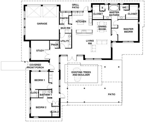

Floor plan

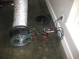

Testing and commissioning of the building enclosure and mechanical systems was performed to ensure the house will operate as designed. The following tests were performed:
  • Air leakage
  • Duct leakage
  • Local air flows
  • Outside air duct air flow
  • Proper configuration of fan cycling control
