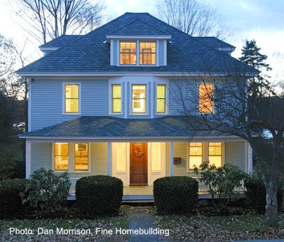

Front exterior of home after renovation

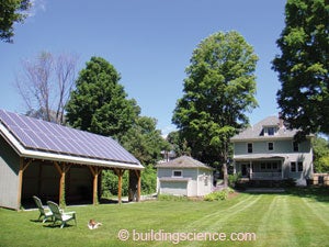

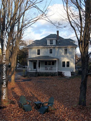

Rear exterior of home after renovation

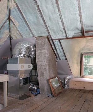

Roof: Unvented

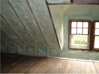

Attic Insulation: R-60 with 4” rigid foam on the exterior and 5” high density sprayed polyurethane foam to the underside of the roof sheathing

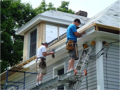

Roof insulation: Two layers of 2” polyisocyanurate rigid insulation

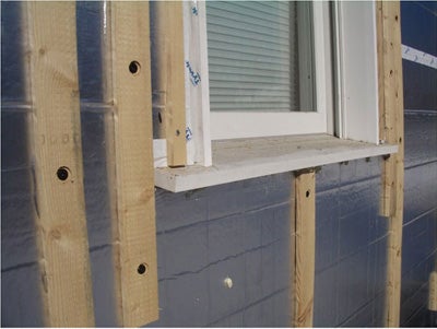

Window Specifications: Double-glazed, Low-E, argon-filled: U=0.33, SHGC=0.33.

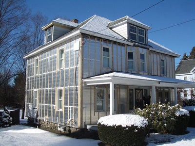

Wall Insulation: R-41 with blown cellulose cavity insulation and 4” of rigid foam on the exterior

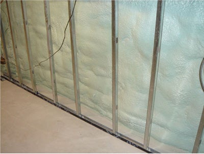

Foundation Wall Insulation: R-20 walls with 4” high density sprayed polyurethane foam

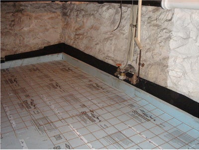

Slab Insulation: R-10; 2” XPS insulating sheathing under the slab
Drainage Plane: Taped foil-faced polyisocyanurate

High density sprayed polyurethane foam to the underside of the roof sheathing
Windows with exterior sheathing and furring strips
Four inches of exterior rigid insulation
R-20 foundation walls with 4" high density sprayed polyurethane foam insulation
Two inches of XPS insulating sheathing under the slab

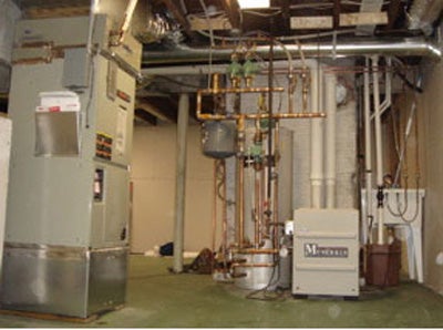

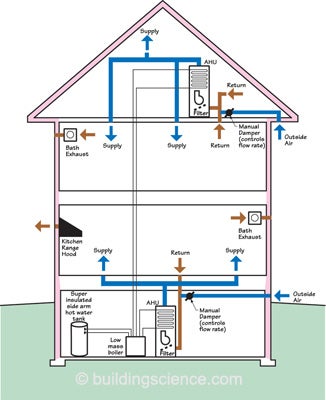

Heating: 92% AFUE sealed combustion gas boiler in conditioned space
Cooling: 13 SEER split system in conditioned space
Ventilation: Supply-only system with outside air to return; run at low speed with an ECM motor
Filter: MERV 13
Return Pathways: Transfer grilles at bedrooms
Ducts: Sheet metal trunk and flex runouts in conditioned space
DHW: 0.8 EF side-arm storage tank

Site Generated Power: 4.9 kW PV system
Mechanical design schematic
Sealed combustion gas boiler in conditioned space
4.9 kW PV system

  • Large overhangs with crown molding to accommodate additional exterior foam
  • Front porch
  • Maintenance-free fiber cement siding and trim
