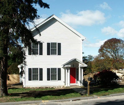

Habitat for Humanity of Greater Lowell (HfHGL) has partnered with Building Science Corporation (BSC) on previous new construction projects. This working relationship continued with HfHGL’s renovation of a mid-19th century farmhouse into affordable housing meeting Building America performance standards. BSC guided the project through the compound challenges of implementing high performance construction in the context of Habitat’s construction process and in the context of a 150 year-old structure in an historic district.
BSC applied its 10-20-40-60 insulation performance guideline to the overall project plan. The guideline was met through installation of a new insulated slab, application of closed-cell spray foam insulation to the interior of the field stone foundation walls, and the addition of thick exterior insulation to the roof and wall assemblies. BSC developed details to achieve robust water management, maintain air and thermal barrier continuity, and respect the historic character of the property. The exterior of the insulating sheathing was designated to perform both as drainage plane and air barrier for the wall assembly. Comprehensive testing has evaluated the effectiveness of the air barrier system. Utility bill monitoring will provide further assessment of the overall efficacy of the high performance renovation.
Project Team: Habitat for Humanity of Greater Lowell, Shawsheen Technical High School, Building Science Corporation
Location: Bedford, Massachusetts
Description: 1,504 ft2 two-story three bedroom, one-and-a-half bath home
Completion Date: November 2009
Estimated Annual Energy Usage: 35% energy use reduction over the Building America benchmark; $930 estimated annual savings
Habitat for Humanity of Greater Lowell (HfHGL) acquired control of a lot able to accommodate 7 new units of affordable housing. HfHGL decided to renovate the existing 1850’s-era farmhouse on the site as an additional affordable housing unit. Building Science Corporation, worked with HfHGL to develop plans to renovate the farmhouse to Building America performance levels.
The farmhouse had already been altered and adapted many times to suit the changing needs and means of occupants. Some of the additions were poorly constructed and were demolished. The building received new mechanical, plumbing and electrical systems. The kitchen and bathrooms were entirely remodeled. The interior was modestly reconfigured to accommodate 3 bedrooms and a full bathroom on the 2nd floor, closets for each bedroom, and laundry on the main level. Thermal enclosure improvements brought both the attic and basement inside conditioned space.
