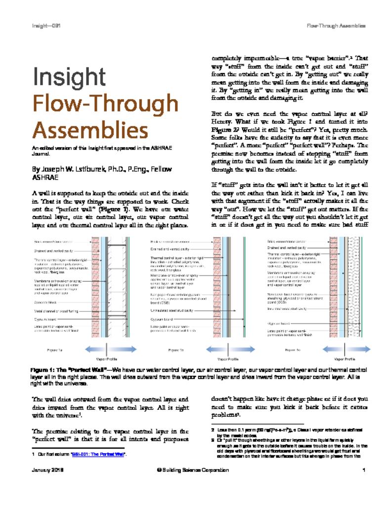

A wall is supposed to keep the outside out and the inside in. That is the way things are supposed to work. Check out the “perfect wall” (Figure 1). We have our water control layer, our air control layer, our vapor control layer and our thermal control layer all in the right places. The wall dries outward from the vapor control layer and dries inward from the vapor control layer. All is right with the universe1.
The premise relating to the vapor control layer in the “perfect wall” is that it is for all intents and purposes completely impermeable—a true “vapor barrier”.2 That way “stuff” from the inside can’t get out and “stuff” from the outside can’t get in. By “getting out” we really mean getting into the wall from the inside and damaging it. By “getting in” we really mean getting into the wall from the outside and damaging it.
But do we even need the vapor control layer at all? Heresy. What if we took Figure 1 and turned it into Figure 2? Would it still be “perfect”? Yes, pretty much. Some folks have the audacity to say that it is even more “perfect”. A more “perfect” “perfect wall”? Perhaps. The premise now becomes instead of stopping “stuff” from getting into the wall from the inside let it go completely through the wall to the outside.
If “stuff” gets into the wall isn’t it better to let it get all the way out rather than kick it back in? Yes, I can live with that argument if the “stuff” actually makes it all the way “out”. How we let the “stuff” get out matters. If the “stuff” doesn’t get all the way out you shouldn’t let it get in or if it does get in you need to make sure bad stuff doesn’t happen like have it change phase or if it does you need to make sure you kick it back before it causes problems3.
Figure 1: The “Perfect Wall”—We have our water control layer, our air control layer, our vapor control layer and our thermal control layer all in the right places. The wall dries outward from the vapor control layer and dries inward from the vapor control layer. All is right with the universe.
Figure 2: The More Perfect Perfect Wall? Can it be so easy that all we have to do to make the perfect wall more perfect is leave out the vapor control layer?
