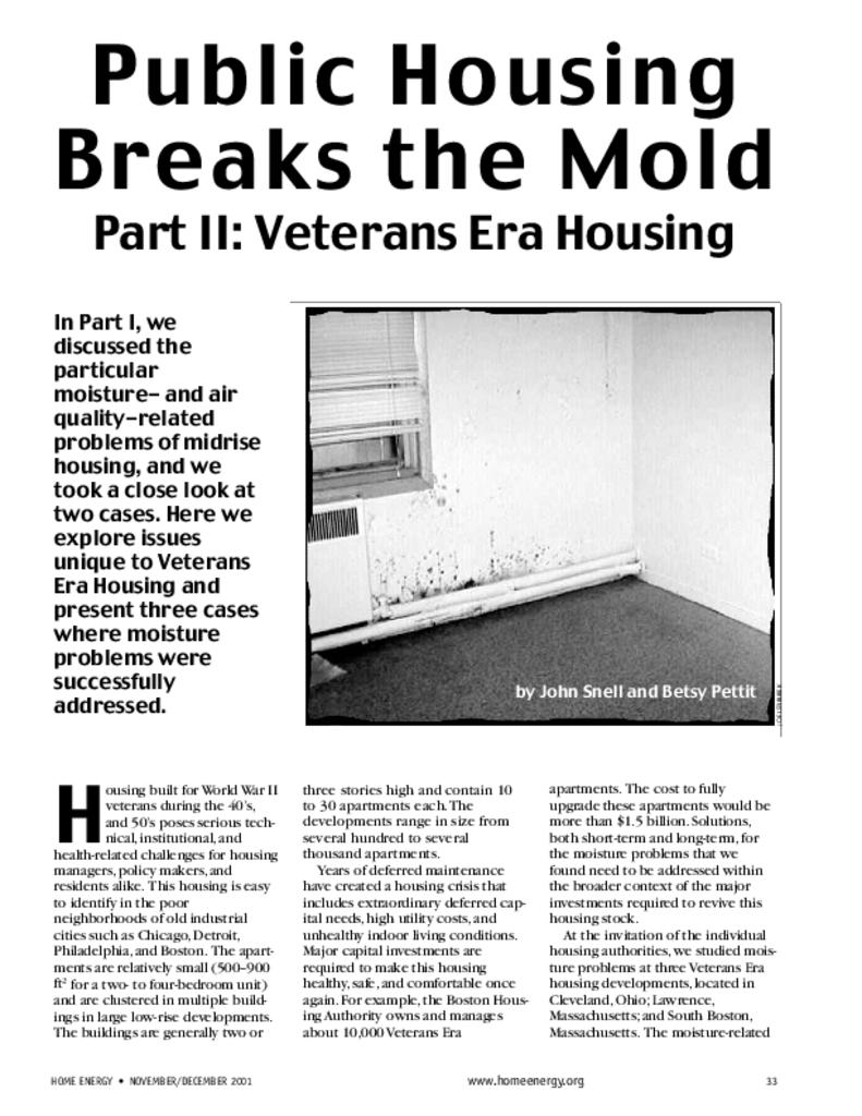

The moisture problems in Cleveland's housing included a sensation of dampness in the apartments, window condensation and deterioration, water damage to plaster walls, and mold growth. The apartment buildings are two-story uninsulated masonry structure built just after the end of World War II. The 15 buildings contain 150 apartments, ranging in size from 800 to 900 ft2. The space conditioning systems are hydronic fin tube radiators connected to a central heating system located in an attached boiler room for each building. No controlled mechanical ventilation, such as exhaust fan systems in kitchens or bathrooms, was installed.
The housing authority had recently installed wood-framed replacment windows in the development, because tenants had complained that the old windows were leaking rainwater. Reduced air leakage through the new windows, however, caused moisture condensation on the windows and mold on the walls and ceilings.
Occupant loading in the relatively small apartments was high, based on visual inspection. Occupant activities also implied high moisture generation in the apartments. Specific examples include hanging up laundry to dry indoors and heavy use of the installed gas stoves for cooking with inadequate kitchen exhaust ventilation (see Table 1). We observed mold growth at exterior corners and condensed water and water stains on window frames. The window stains indicated significant current and past condensation on the widow glass.

Investigators concluded that high interior moisture levels, due to inadequate ventilation and to high moisture source strength, caused the sensation of dampness. They also decided that the mold and mildew, window condensation, interior paint damage, and plaster damage were caused by high interior moisture levels combined with cool surfaces.
The recommended solution was to reduce interior vapor pressure and to increase interanl air flow.
Reduce interior vapor pressure. Installing controlled mechanical ventilation in each apartment would dilute interior moisture and other pollutants. We recommended installing exhaust-only ventilation to provide approximately 15 CFM per occupant, extracting air form the washrooms and stairwell/hallway areas, and exhausting this air to the exterior via ductwork. Ventilation should operate continuously in order to maintain interior moisture levels between 30% and 45% relative humidity at 72°F during the winter months.
Increase interior air flow. We recommended undercutting all interior doors 21/2 inches (from the top of the floor covering to the underside of the door) to promote air change in secondary rooms. The continuously operating exhaust fan would then induce 2-3 Pa pressure differences necessary to ventilate rooms. Exterior air would enter the rooms and pass into the common areas. When these recommendations were followed, the problems were eliminated. . .
