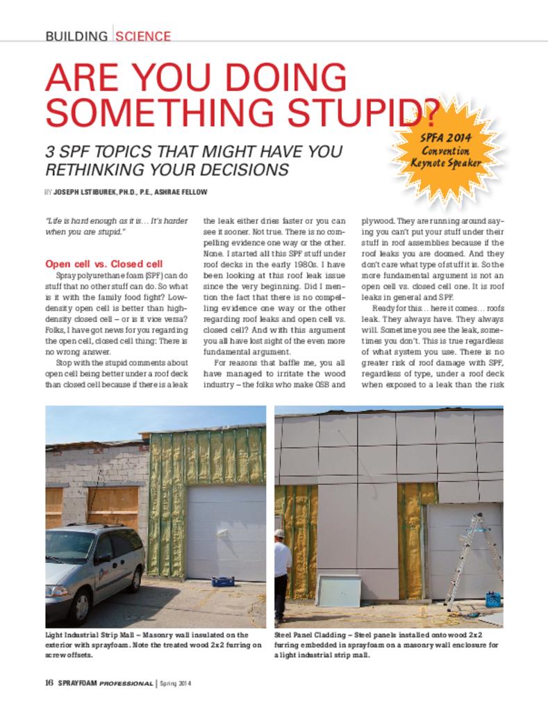

Light Industrial Strip Mall (above left) – Masonry wall insulated on the exterior with sprayfoam. Note the treated wood 2x2 furring on screw offsets; Steel Panel Cladding (above right) – Steel panels installed onto wood 2x2 furring embedded in sprayfoam on a masonry wall enclosure for a light industrial strip mall.
