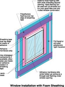

  • Window flashing – Window flashing details are wall assembly or cladding specific. See Figures 14a and 14b and refer to the Water Management Guide.
Figure 14a
Figure 14b

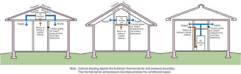

    • Ducts in conditioned space - The preferred method for keeping HVAC ducts and mechanical equipment inside conditioned space is keeping them in the living space. Moving the conditioned boundary down so that the crawlspace is conditioned works as well. The crawlspace must be conditioned (with the air barrier and thermal barrier following the foundation) so that the crawlspace does not become a potential (large) moisture trap. In no case should HVAC ducts be placed within exterior wall assemblies-this is not part of what is meant by ducts in conditioned space. See Figures 15a-c.
      Alternatively, moving the conditioned boundary up to the underside of the roof sheathing so that the attic is also conditioned works as shown below.
      A vented attic assembly may be used in this climate as long as the ceiling plane is air tight and no ductwork or air handling equipment is located in the attic.
    Figures 15a, 15b, 15c
  • Figure 15d

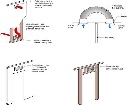

    • Transfer grilles and jump ducts – Single air returns require transfer grilles to provide return pathways that prevent pressurization of bedrooms. For appropriate sizing for ducts, including these pressure relief methods, see Cooling Sizing and see Figures 16a-d.
      Figures 16a, 16b, 16c, & 16d
