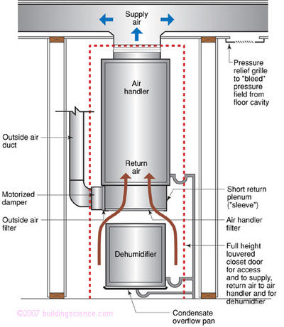

Three general approaches to supplemental dehumidification in residences are recommended: stand-alone dehumidifiers (Figure 6); enhanced air conditioning systems (variable speed blowers and compressors); and ventilating dehumidifiers. Each approach has advantages and disadvantages.
Air handler located and accessed within interior conditioned space.
- Dehumidifier and condensate overflow pan supported by metal stand.
- Dehumidifier drain plumbed to air handler condensate system.
- Outside air provided to return side of system with motorized damper control.
- Flow controller for outside air should not allow air handler to run with motorized damper open for 15 minutes after cooling is de-energized to prevent re-evaporation of condensate from coils and drain pan.
- Outside air is controlled by a motorized damper. Closing the outside air damper during unoccupied periods will allow the flow controller to periodically mix the interior air without bringing in outside air helping the dehumidifier control interior RH – humid air is brought to the dehumidifier. The cooling function of the A/C can also be shut down during this time (i.e. A/C on blower only operation).
- Pressure relief grille provided to “bleed” accidental/incidental pressure field created by duct leakage.
The use of a stand-alone dehumidifier plumbed/drained to a condensate drain has the advantage of low cost (adds approximately $300 to the typical house). The disadvantage is the heat generated by the dehumidifier and it’s effect on comfort. Additionally, operating costs are the highest of the three general approaches. However, it is a simple to implement solution and typically compensates for oversizing of equipment.
The use of enhanced air conditioning systems has the advantage of not having to install a separate piece of equipment. The disadvantage is a substantial increase in cost (adds approximately $1,000 or more to the typical house). Additionally, equipment sizing is critical. However, implementation is the easiest of the three systems and costs are likely to drop the most as these systems become “commodity items” as opposed to “special order.”
The use of ventilating dehumidifiers has the advantage of the lowest operating cost (since these dehumidifiers have been optimized for humidity removal). The chief disadvantage is their current cost (adds approximately $2,000 to the typical house).
