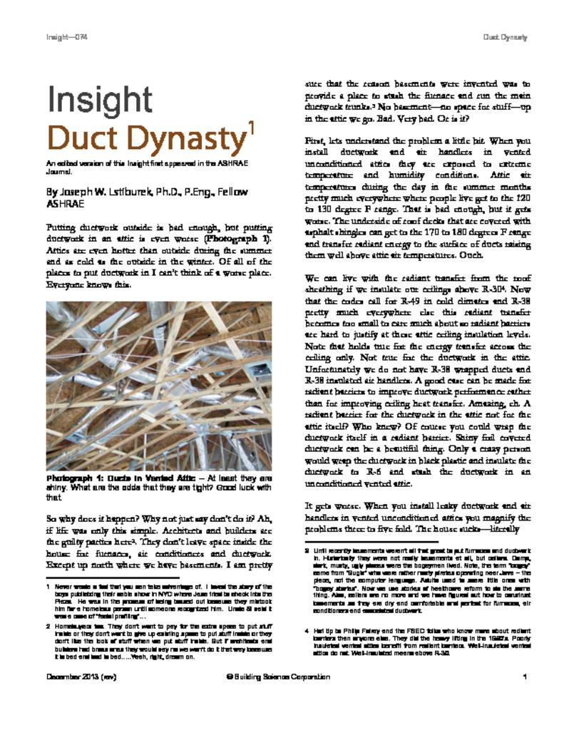

Putting ductwork outside is bad enough, but putting ductwork in an attic is even worse (Photograph 1). Attics are even hotter than outside during the summer and as cold as the outside in the winter. Of all of the places to put ductwork in I can’t think of a worse place. Everyone knows this.
Photograph 1: Ducts in Vented Attic
– At least they are shiny. What are the odds that they are tight? Good luck with that.
So why does it happen? Why not just say don’t do it? Ah, if life was only this simple. Architects and builders are the guilty parties here2. They don’t leave space inside the house for furnaces, air conditioners and ductwork. Except up north where we have basements. I am pretty sure that the reason basements were invented was to provide a place to stash the furnace and run the main ductwork trunks.3 No basement—no space for stuff—up in the attic we go. Bad. Very bad. Or is it?
