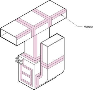

Ductwork, furnaces and air handlers should be sealed against air leakage. The only place air should be able to leave the supply duct system and the furnace or air handling unit is at the supply registers. The only place air should be able to enter the return duct system and the furnace or air handling unit is at the return grilles. A forced air system should be able to be pressure tested the way a plumber pressure tests a plumbing system for leaks. Builders don’t accept leaky plumbing systems, so they should not accept leaky duct systems.

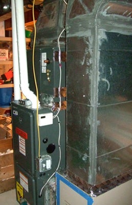

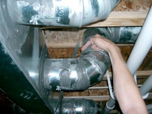

Supply systems should be sealed with mastic in order to be airtight. All openings (except supply registers), penetrations, holes and cracks should be sealed with mastic or fiberglass mesh and mastic. Fabric/rubber duct tape (common duck tape developed for temporary repair of cotton duck tarps and raingear has thousands of uses; sealing ducts is not one of them) should not be used: after hot and cold cycling, the adhesive dries out and fails. Tapes meeting UL 181A or 181B may provide reasonable performance. These must be applied only to clean, dry, and dust-free surfaces.  Sealing of the supply system includes sealing the supply plenum, its attachment to the air handler or furnace, and the air handler or furnace itself. Joints, seams and openings on the air handler, furnace or ductwork near the air handler or furnace should be sealed with both fiberglass mesh and mastic due to greater local vibration and flexure.

Air Sealing Details
Air Handler
Rigid Duct

Photograph 1: Retrofit Sealing of Air Handler and Plenum
Photograph 2: Metal duct system with mastic joints
