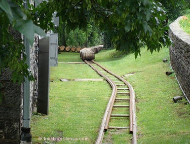

Contrary to popular belief the unique shape of oak barrels used for bourbon making has nothing to do with “flavor” and everything to do with mobility. Barrels are easy turn (rotate) around their “bulging middle”4 and are easy to roll on tracks (Photograph 1). Size, that surface area to volume thing, is something else. After 200 years, there is absolutely no size consensus according to the bourbon folks. Some bourbon is made in larger than “standard” sized barrels, some bourbon is made in smaller than “standard” barrels, but most is made in “standard” sized barrel.5
Photograph 1: Bourbon Barrel Railroad – The shape of the barrels allows them to easily roll on parallel rails.

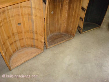

Oak barrels used in the manufacture of bourbon are “charred” to varying degrees in processes that are closely held “secrets” (Photograph 2). The particular type of oak, where it is grown, how old, and what part of the tree the oak comes from are even more closely held “secrets.” The “clear liquid spirit” that is obtained from the distillation of a “secret mixture” of grains in a process called “sour mash fermentation” is stored for varying periods of time under varying and variable conditions in these charred barrels and the result is bourbon. The varying periods of time under varying and variable conditions is where building science comes in.
Photograph 2: Charring of Barrels – Un-charred, medium charred, heavily charred barrels. The charring leads to distinctive flavors as the “clear liquid spirit” changes its color due to the charring to a deep amber color and changes its taste and smell into a uniquely American experience.

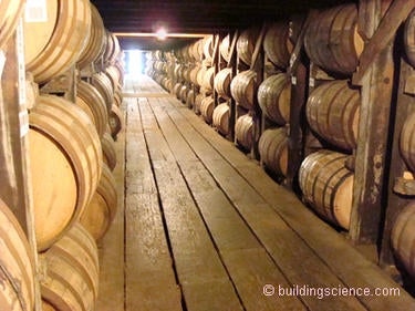

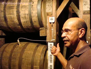

Photograph 3: Barrel Location “Sweet Spot” – In every warehouse there is a location where the resulting bourbon tastes better than bourbon from anywhere else. Clever bourbon makers want to understand why. Measuring the temperature profile of the liquid over daily, weekly, monthly and yearly cycles of the “sweet spot” barrel is helping manufacturers get more “sweet spots” and build more warehouses with bigger sweet spots. How do you know if it is the “sweet spot” barrel? Each barrel is tasted and an “expert” bourbon taster says what is what…. I wonder if they are hiring?
The temperature–time regime of barrel aging apparently is a very, very big deal. In every warehouse there is a location where the resulting bourbon tastes better than bourbon from anywhere else. Clever bourbon makers want to understand why. Measuring the temperature profile of the liquid over daily, weekly, monthly and yearly cycles of the “sweet spot” barrel is helping manufacturers create more “sweet spots” and build warehouses with bigger sweet spots. How do you know if it is the “sweet spot” barrel? Each barrel is tasted and an “expert” bourbon taster says what is what. The goal is to have an entire warehouse of “sweet spots.”

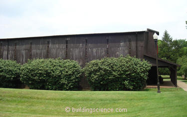

Photograph 4: A Beautiful Sight – Notice that the barrels are stored in a manner that allows air circulation. Warehouses don’t have “floors” in the typical sense. They have “catwalks” between stacks of barrels that are both cross-ventilated and stack (air flow from down low to up high) ventilated.
Let’s look at what the “old masters” used to do—to establish a base of comparison. They constructed high mass warehouses coupled to the ground (Photograph 4). Tin roofs were installed over heavy timber decks, supported by thick stone walls. The foundation systems were dirt crawlspaces. The exposed dirt provided humidification in the winter and temperature moderation throughout the year. Cross ventilation and stack ventilation (air flow from down low to up high) further moderated conditions (Photograph 5 and Figure 1). The high mass of the construction and high thermal resistance of the construction (Photograph 6) slowed temperature swings. This resulted in beautiful, but expensive buildings. You can guess the next question: “can we get kind of similar results with less money?”
