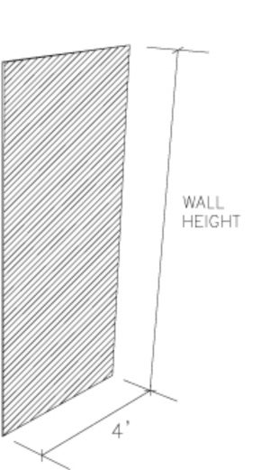

Braced wall panels can be used instead of completely covering the entire building with plywood or OSB. While many types of braced wall panels are acceptable, the most common type of braced wall panels are: 1. A 4 foot wide sheet of plywood or OSB for outside walls and 2. Gypsum installed on interior walls. The various types of braced wall panels are described in Section R602.10.3 Braced wall panel construction methods. Standard braced wall panels need to a full 4 foot width with no cut outs from doors or window opening. Narrower panels can be used if the requirements of Section R602.10.6 Alternate braced wall panels are met.

Figure 1: Braced wall panel
