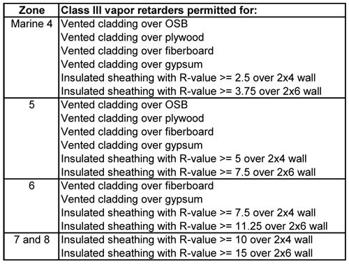

With the new definition for vapor retarder classes, new code language concerning the use for the new classes was also included. Class I and Class II vapor are needed to be installed on the warm in winter side of the insulation in Climate Zones 5, 6, 7, 8 and Marine 4 (Section N1102.5 Vapor retarders); however, Class III vapor retarders can now be used instead of Class I or II vapor retarders if the conditions of Table N1102.5.1 Class III vapor retarders (as listed below) are met.

  • N1102.5.1 Class III vapor retarders
