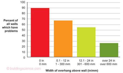

The shape of the roof and overhangs also have a critical impact. Field measurements [1] and computer modelling [2] have shown that overhangs and peaked roofs reduce rain deposition by approximately 50%.  A damage survey of wood frame buildings in British Columbia [3] found that the size of a buildings overhang correlated directly with the probability of rain-related damage (Figure 1).
Figure 1: Wall problems as a function of the overhang size from a field survey.

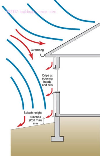

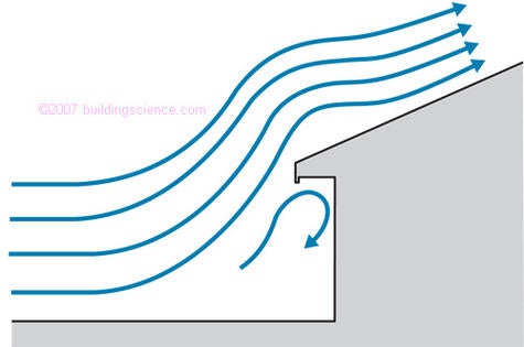

Peaked roofs and overhangs protect a wall from rain by shadowing and redirecting airflow (Figure 2). Hipped roofs provide an opportunity to shelter the walls from rain on all four sides of the building and also increase the resistance to damage during high winds.
Field measurements [4,5,6,7], computer modelling [8,9], and wind tunnel testing [10] have provided an indication of the quantity of driving rain deposition that can be expected on vertical walls. For many low-rise buildings, the amount of rain deposited on the worst part of the building is in the order of 10 to 20% of the product of wind speed and rainfall intensity for each orientation. Thus the amount of rain deposited on the walls of houses erected on exposed sites could be in the order of tens to hundreds of litres per square meter per year (0.2 to 2 gallons per square foot per year).  Sheltered locations and single-storey houses with wide overhangs will be exposed to much less than this amount of rain.
Figure_02: Influences of overhangs and pitched roofs on wind and rain flow
Figure 2: Influence of overhangs and pitched roofs on wind and rain flow.

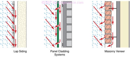

Once water is on the wall it will form a film and begin flowing downward under the force of gravity.  Wind flowing over the surface will tend to deflect the flow from this path and, in extreme cases, may even force water upward. Surface features such as trim, surface texture, and openings can greatly affect the flow paths of this surface drainage, either concentrating or dispersing surface flows.
Traditional surface details on old and vernacular buildings often served the function of directing water away from sensitive areas (e.g., windows) and distributed surface water in such a way as to prevent the concentrated streams which cause staining. The copious use of drip edges and slopes also ensured that surface water was shed from the building surface as often as possible.
Figure_03: Principles of rain deflection
Figure 3: Principles of rain deflection.

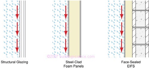

Perfect barriers stop all water penetration at a single plane. Such perfect control required the advent of modern materials.  Some examples of perfect barrier walls are some window frames, and some metal and glass curtain wall systems (Figure 5). Because it is difficult to build and maintain a perfect barrier wall, most walls are designed as, or perform as, imperfect barrier wall systems of either the mass type or the screened type. However, some systems, usually factory built, provide wall elements that are practical perfect barriers. The joints between perfect barrier elements may be also designed as perfect barriers (e.g. a single line of caulking). Such joints have a poor record of performance and should not be used to control rain entry.
 Figure_05: Examples of perfect barier wall systems
Figure 5: Examples of perfect barrier wall systems.

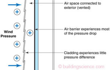

A vented airspace also allows for both some degree of pressure moderation. Pressure moderation is the term given to the mechanism whereby wind pressure differences across the cladding are reduced by connecting an air space behind the cladding with the wind-induced pressure acting on the exterior (Figure 7). By reducing air pressure differences across the cladding, rain will not be forced across openings by this force, while the standard features of capillary break, drainage, and flashing deal with the other rain penetration forces. If the air pressure is completely eliminated (not practical in the field [12,13,14]), the process is termed pressure equalisation.
Figure 7: Pressure moderated air space.

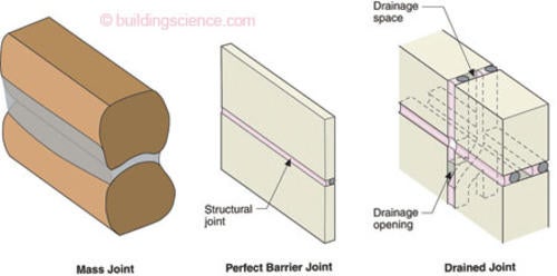

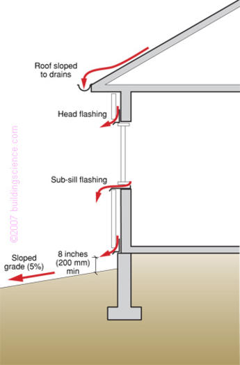

Joints between the wall and penetrating items or between joints within components (such as between the window frame and glazing) can use any one of the three strategies applied to walls (Figure 9). Joints are often designed as face-sealed perfect barrier elements made of sealant. These joints have a very high chance of failure, and may defeat the otherwise good performance of a drained or storage wall system. They are not recommended.
 Figure_08: Drainage and flashing concepts
Figure 8: Drainage and flashing concepts.
Figure 9: Three rain control strategies applied to joints.
Flashing must be made of a waterproof material (such as PVC, metal, or peel and stick membranes, not building paper or housewrap) since it is installed in a nearly horizontal manner [17]. Flashing must be installed in a continuous manner with an outward slope. Leaks often occur at lapped joints between lengths of rigid flashing, so these should be sealed, not just lapped.
Windows and especially mulled window joints and window corners often leak rainwater into the wall.  To deal with this eventuality (some would say likelihood), sub-sill flashing should be installed.  Essentially, the rough window should be prepared in such a way as to make it water resistant. The head of window should also be protected with flashing that directs surface rainwater away from the window and the window opening. This flashing directs water on the surface of the cladding and in the drainage gap safely outward. Head flashing and window sills should extend past the window jambs by at least 2” (50 mm) so that water flowing laterally on the flashing does not concentrate at the jamb but is directed away and dripped clear of the face of the cladding.

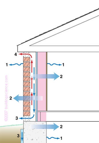

Despite all attempts to resist and drain water, field experience has shown that some water may still penetrate or be built in during construction. Drying of this moisture must be provided for.
Moisture can be removed from a wood framed wall clad with drained siding by (Figure 8):
  • evaporation from the inside or outside surfaces,
  • vapour transport by diffusion, air leakage, or both, either outward or inward;
  • drainage, driven by gravity, and
  • ventilation, if provided for.
Drainage is capable of removing the greatest volume of water in the shortest period of time. Hence, as described above, it is a very important mechanism for moisture control. Provided a clear drainage path exists (e.g. cavities, slopes, drainage openings), a large proportion of rainwater that penetrates the cladding  can flow out of a wall.
A small but significant amount of water will usually remain attached to surfaces by surface tension and absorbed into materials by capillary forces even in walls with excellent drainage. Sidings of wood, fibercement, and masonry will also absorb and store moisture. This moisture can only be removed from a wall system by either diffusion or airflow.
Diffusive drying of water that is not removed by drainage can dry in either direction, depending on the wall system and the climate. In colder climates the vapor flow is often outwards, and inward drying only occurs during warm weather or when the sun shines on a wall. In warmer climates drying will often be to the interior.
If absorbent cladding materials or retained water in the drainage space is heated by direct solar exposure, the temperature rises well above the outdoor air temperature. This generates very large inward water vapour drives (which accelerate drying of the cladding), even in predominately heating climates. These inward drives can cause dangerous summertime condensation within wood framed walls, especially if a low-permeance vapor barrier (e.g., polyethylene) or finish (e.g. vinyl wall paper, mirrors, and cabinets) are used on the interior [20,21,22].  Additional control is often required to control inward vapor drives, and an outer layer with moderate or low vapor permeance (such as foam sheathings or thin-profile structural sheathing) is recommended.
Hence, in very cold climates, a vapour barrier of polyethylene sheet or aluminum foil may be acceptable. However, if absorbent cladding is used, a Class III vapor retarder combined with exterior insulating sheathing may be required to provide sufficient vapour diffusion control in cold weather while still allowing vapour to flow inward during warm weather.
 Figure_10: Moisture removal mechanism in drained and screened walls
Figure 10: Moisture removal mechanism in drained and screened walls.

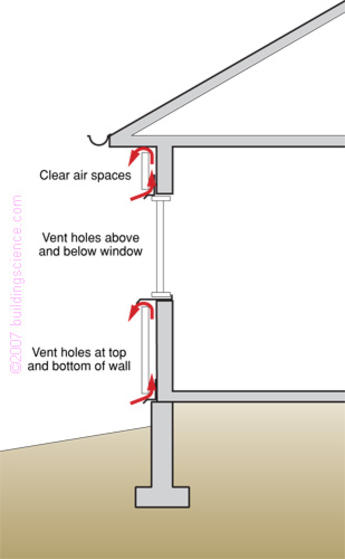

Ventilation, or exterior airflow behind the cladding driven by wind pressure differences on the face of the building or solar heated air rising, is useful since it accelerates drying. Ventilation bypasses the high vapour resistance of claddings such as vinyl siding, metal panels, and cement board, thereby allowing outward drying.  A recent study [18] and previous European research [19] has confirmed that ventilation drying occurs. This research shows that a clear space should be provided behind cladding to encourage ventilation, and that clear vents must be placed at the top and bottom for the most effective ventilation. Lapped siding with joints unsealed by thick paint layers tends to act as if it were ventilated.
 Figure_11: Ventilation concepts
Figure 11: Ventilation concepts.

Perfect barrier systems, especially face-sealed versions, often fail to perform as designed, if not initially, then after many years of exposure. The perfect barrier systems that appear to function in the field usually lend their performance to the fact that other layers are providing drainage and/or storage: in effect these "perfect barrier systems" are acting as screened systems or mass systems. Perfect barrier wall elements built with tight quality control in factory conditions and connected in the field with drained-screened types of joints may be able to provide good performance for a long service life. In almost all cases, drained systems with the same amount of material and labor will provide better, longer-lasting rain control.
If you must use a perfectly sealed system, pay extra attention to surface drainage, joints, and buildable details. Quality control is essential on site, and maintenance important. Use these systems under low exposure conditions, and/or in situations in which a rain leak will not be catastrophic (e.g., there are no moisture sensitive materials). Consider a redundant backup system to deal with the possibility of local failures.
Concealed barrier approaches tend to have better performance than face sealed systems (as the key components are less exposed to temperature and radiation extremes). This is especially true for roofs: the membranes in inverted roofs have much longer life than exposed membrane face sealed roofs.
