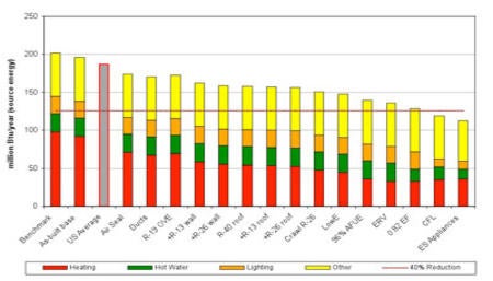

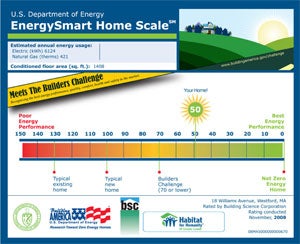

The various mechanical and enclosure upgrade options were explored through a series of parametric annual loads studies. The studies show the percent improvement of each successive upgrade relative to the benchmark. The final study shown above outlines the mechanical and enclosure upgrades and indicates the Westford House, as designed, achieves a 44.1% source energy reduction relative to the benchmark, giving the home a HERS score of 50.
Parametric Study

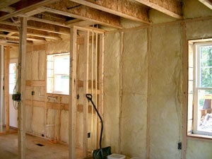

Roof Assembly: Rafter framed unvented attic with R-66 roof insulation: unfaced fiberglass batt insulation (R-40) in rafter bay with two 2” layers of foil-faced polyisocyanurate insulating sheathing (R-26) on top of roof sheathing (joints staggered and taped).
Unfaced fiberglass batt insulation in rafter bays
Wall Assembly: 2x6 walls at 24” o.c. with R-45 wall insulation: unfaced fiberglass batt insulation (R-19) in wall cavity with two 2” layers foil-faced polyisocyanurate insulating sheathing (R-26) on outside face of stud (joints staggered and taped).
Wall Assembly

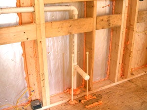

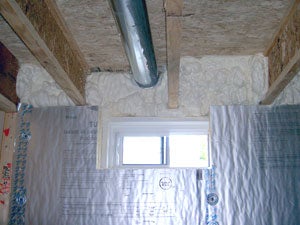

Air Sealing: Maximum 2.5 in2 leakage area per 100 ft2 of enclosure area. Critical seal air sealing approach with primary air barrier maintained at interior gypsum walls and ceilings. Closed cell spray foam installed at first floor rim joist (with mineral wool insulation over top providing a thermal barrier). Low expanding foam used at second floor rim joist area (covered with fiberglass batt insulation). Adhesives and sealants used for air seal between framing members, between framing members and exterior insulating sheathing, around windows and doors, and at all mechanical and electrical penetrations through the enclosure.
Sealant around penetrations
Foundation Assembly: Conditioned basement with two 2” layers foil-faced polyisocyanurate insulating sheathing (R-26) applied to wood furring strips, 2” XPS (R-10) installed below concrete slab.
Foundation Assembly

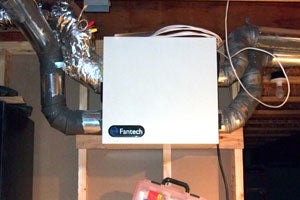

Ventilation: Central fan integrated supply only ventilation controlled with Aprilaire controller. Fantech energy recovery ventilator (ERV) also installed.
Energy recovery ventilator

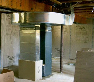

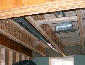

Space Conditioning Distribution: Air handler furnace with sheet metal trunks and run-outs installed in conditioned space. Ducted return from first floor with transfer grilles above bedroom doors.
Sheet metal trunk and runout

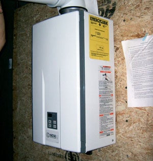

DHW: 0.82 EF instantaneous gas water heater
Instantaneous gas water heater

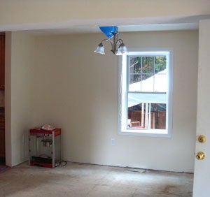

Lighting: ENERGY STAR® CFLs
Lighting

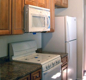

ENERGY STAR® appliances

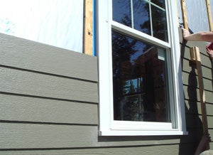

Design Challenge: Installing Windows & Doors in 4” of Foam
So how do you install windows and doors when you have 4” of insulating foam sheathing, which just so happens to have no structural strength, on the outside of your wall? This was the question that BSC set out to answer. First, there was the idea of the plywood box, then came the mock-ups on the back deck of the office, and finally the drawing details. Construction on the Westford House started soon after and along with the framing, the plywood boxes were installed. BSC went to the site and demonstrated how to install and properly flash the windows. The volunteers then finished the job, successfully implementing the construction details with the plywood box.
