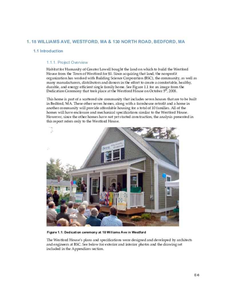

Habitat for Humanity of Greater Lowell bought the land on which to build the Westford House from the Town of Westford for $1. Since acquiring that land, the nonprofit organization has worked with Building Science Corporation (BSC), the community, as well as many manufacturers, distributors and donors in the effort to create a comfortable, healthy, durable, and energy efficient single family home. See Figure 1.1 for an image from the Dedication Ceremony that took place at the Westford House on October 5th, 2008.
This home is part of a scattered site community that includes seven houses that are to be built in Bedford, MA. These other seven homes, along with a farmhouse retrofit and a home in another community will provide affordable housing for a total of 10 families. All of the homes will have enclosure and mechanical specifications similar to the Westford House. However, since the other homes have not yet started construction, the analysis presented in this report refers only to the Westford House.
Figure 1.1: Dedication ceremony at 18 Williams Ave. in Westford
The Westford House’s plans and specifications were designed and developed by architects and engineers at BSC. See below for exterior and interior photos and the drawing set included in the Appendices section.
