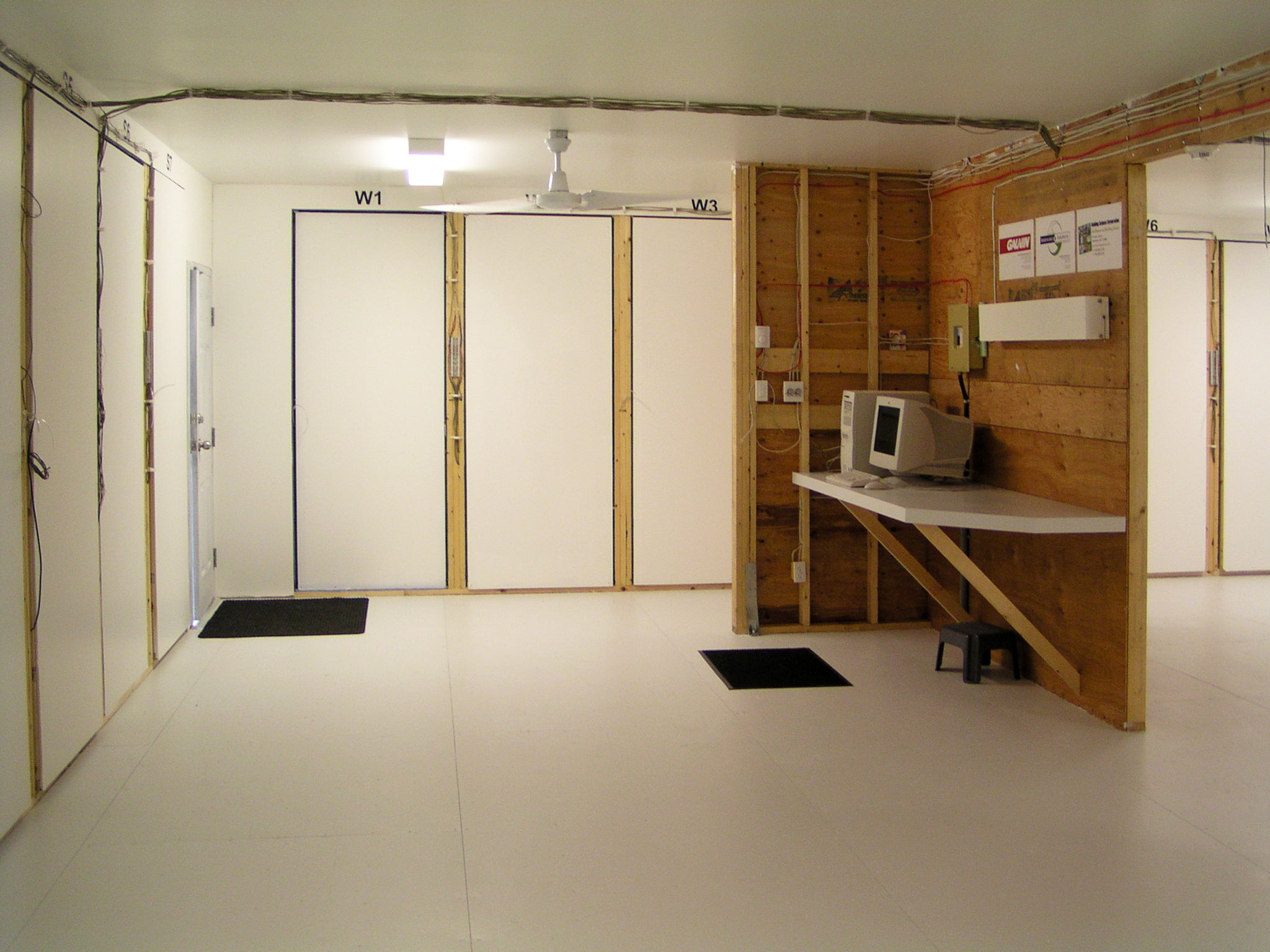

![]() | Interior of the Vancouver Test Hut A 900 square foot building with a total of 28 wall test panels (seven per cardinal direction). A monitoring and control system measures and records performance, controls interior temperature and humidity conditions, and is connected to the internet for remote monitoring and control. |

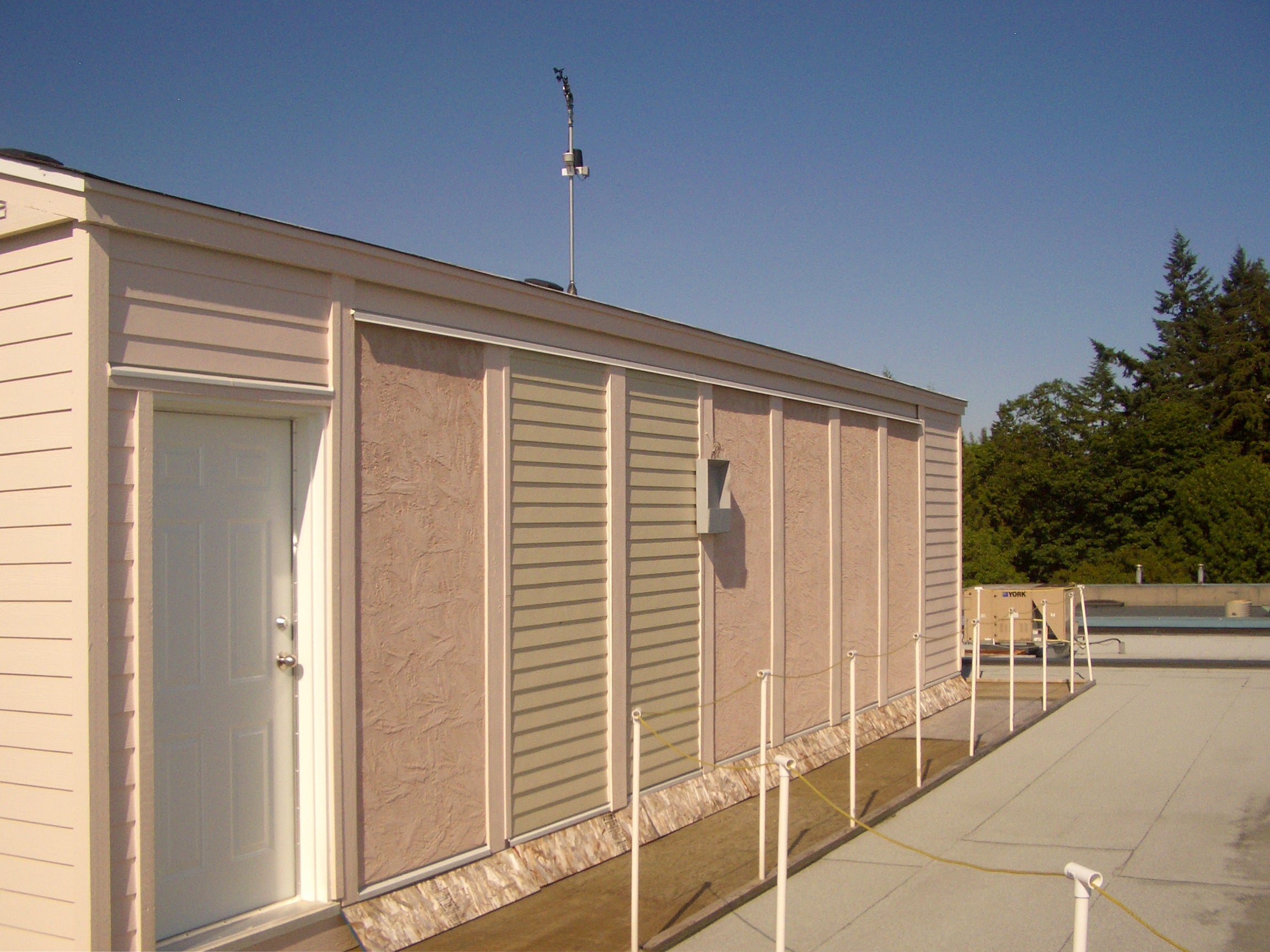

The Vancouver Test Hut is a 900 square foot building with a total of 28 wall test panels (seven per cardinal direction) and 6 roof test panels (three on each of the north and south roof slopes). It is located on the rooftop of a two story commercial office building, allowing for unobstructed exposure to the elements in all directions. In addition to weather exposure, intentional controlled wetting events can be carried out using wetting systems incorporated into the test panels during construction.

![]() | Exterior View of Test Hut Wall Panels Test hut walls can be designed to compare various materials in different assemblies. Some of the assemblies constructed to date have been chosen to represent conventional building practices from the past 40 years while others have been designed to investigate the role of specific assembly layers, or to test possible solutions. All of the test wall panels are exposed to the same exterior conditions relative to their orientation (ie. all North walls can be expected to have the same exterior conditions). After testing is completed, the walls are deconstructed to allow for visual observation of the condition of each component. |

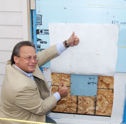

Our data shows that using exterior insulation with a small gap of several millimetres can meet a number of different needs. This alternative wall design is cost-effective, energy-efficient, and durable. However, if the insulating sheathing is vapor impermeable, then the assembly must, of course, be able to dry to the inside.
![]() | Inspecting a Wall Panel with Exterior Insulation Data from Phase III showed no measured or observed moisture related durability concerns of the wood structural sheathing when 1.5” of exterior insulation was installed over OSB. This alternative wall design is also cost-effective and energy-efficient. Phase IV will continue the investigation of exterior insulation by testing a greater range of assemblies and materials not used in previous phases, with the goal of providing a range of usable design strategies. |
