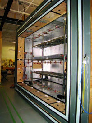

Hot-box Interior (Meter Box)
Key improvements of the TM apparatus over other (i.e. conventional) hot boxes are:
  • the ability to test higher R-value enclosure assemblies
  • a procedure and design that exposes enclosure wall samples to realistic temperature differences while maintaining the interior temperature at normal room temperatures
  • the ability to measure the impact of imposed air flow at a given pressure difference over the specimen in either direction.
  • highly accurate measurements.

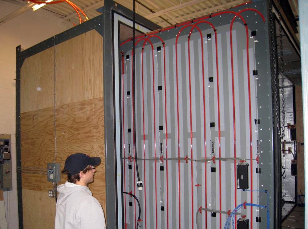

Double Guard on Meter Box
An insulated guard box (left) minimizes the influence of temperature changes in the lab and reduces spatial temperature gradients over the meter box surface. A hydronic guard loop is installed over the outside surface of the meter box (right) to further reduce any spatial temperature gradients; it also all but eliminates any temperature difference between the inside and the outside of the meter box walls (minimizing if not eliminating heat flow through the five enclosing sides of the meter box).

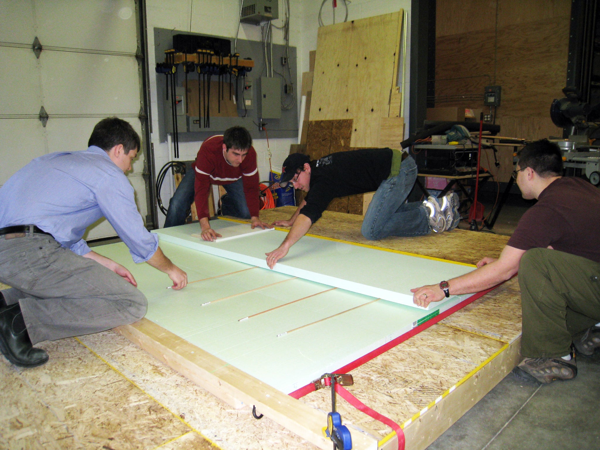

BSC Researchers Constructing Calibration Panels
Commissioning and calibration were conducted by BSC for the measurement and control subsystems and for the complete TM hot box apparatus. Construction, commissioning, and calibration were completed between 2007 and 2009. A base set of walls was then tested to develop a set of reference values for future research.

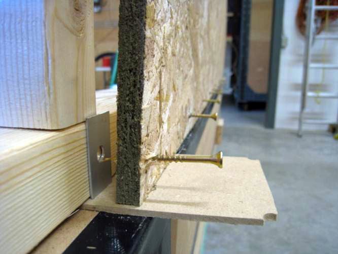

Spacer Installation
In developing the test box method, a variety of spacers and spacer locations were compared in order to attain a representative and repeatable imposed gap for air leakage. The final design used 1/32 in (0.8 mm) spacers to create the imposed air leakage path between components of the assembly.
