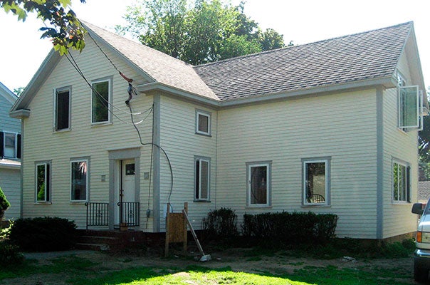

Description: 2,747 ft2, 3 bedroom, 2 bathroom, 2 stories with a full basement single family Victorian
Completion Date: August 2011

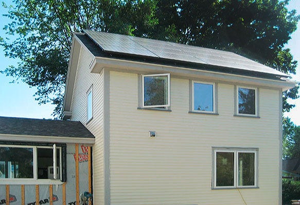

The owners of this circa 1800 Victorian have been postponing renovation and performance upgrade for years in anticipation of a major change in the household structure. With the likelihood of an aging parent’s arrival, they decided to rebuild a portion of the home and add new space to provide a ground floor bedroom with an unfinished office space above. Financial and technical support offered through National Grid’s Deep Energy Retrofit Pilot Program allowed the owners to incorporate a deep energy retrofit (DER) of the existing portions of the building into the larger project. Building Science Corporation provided technical support to the project on behalf of National Grid. The DER was implemented while the home was occupied.
The overall performance improvement strategies for the existing structure include super-insulation enclosure upgrades; new heating, cooling, ventilation and water heating systems; and replacement of lighting and appliances with energy efficient products. The newly constructed addition supports a 5 kW photovoltaic array on the roof.

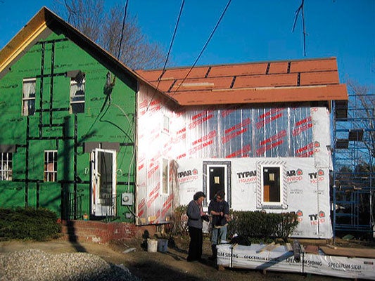

The architect selected a super insulation approach for the roof and wall that supplements fibrous cavity insulation with a thick layer of insulating sheathing to the exterior of existing sheathing. The approach is compatible with assemblies that have restricted access to framing cavities such as with cathedralized ceilings or to situations where space for insulation between and below rafter framing is otherwise limited. Adding a thick layer of insulation exterior to the sheathing also provides robust condensation risk management.

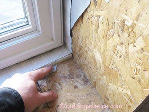

The design employed a layer of sheathing added over existing sheathing as the primary airflow control layer. A layer of plywood is used at the roof. The walls use a proprietary sheathing system consisting of specialized tape and OSB with a water and air control coating. This sheathing system is also used to provide extensions at window openings.
The design uses the “chain saw” approach at the roof-wall interface. In this approach, roof overhangs are sawn off at the wall sheathing so that the air control layer and thermal control layers of the roof connect directly to the corresponding control layers of the wall system.

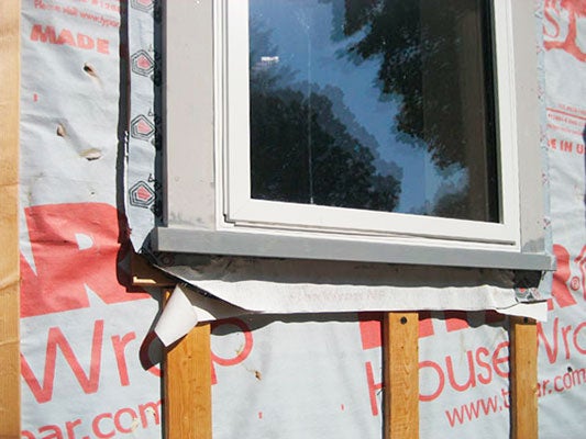

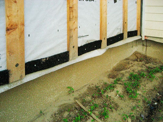

The design includes multiple water control layers in the roof and wall assemblies. On top of the supplemental sheathing, the design uses two layers of foil-faced rigid board insulation with seams offset and taped. For the walls, the primary water control layer is a shingle-lapped layer of housewrap installed over the face of the rigid insulation. Wood furring creates a drainage and ventilation space between the fiber-cement cladding and the housewrap. On the roof, asphalt shingles and underlayment are installed over a proprietary air/water control sheathing system (as for walls) that is installed over the insulating sheathing.

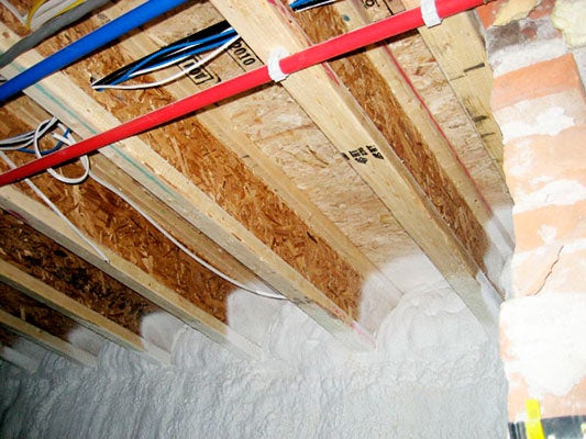

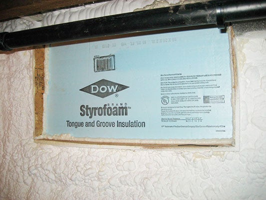

Water issues in the basement are managed by gravel trenches cut into the existing slab and an interior perimeter drain connected to sumps. Closed-cell spray foam on the brick-and-rubble-stone walls and rigid foam surrounding the newly cast slab provide insulation and also direct water to the sub-slab drainage system.

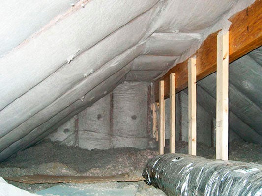

Roof Assembly: R-60 (nominal) Unvented roof assembly: Rafter bays netted and dense-packed with cellulose insulation, ½” plywood over existing board sheathing; fully adhered membrane; 4” polyisocyanurate insulating sheathing in 2 layers; taped OSB sheathing system (Zip System® Roof); 2nd layer of fully adhered membrane; asphalt shingles.
Wall Assembly: R-39 (nominal): Dense-packed cellulose insulation in existing wall framing cavities; taped OSB sheathing system (Zip System® Wall) over existing board sheathing; two layers of 2” foil-faced polyisocyanurate insulating sheathing; housewrap; ¾” furring strips; fiber cement siding.
Window Specifications: Serious Windows triple-glazed, krypton gas, low-E fiberglass windows; U=0.14-0.17, SHGC=0.33-0.42; windows installed over strapping at exterior face of insulating sheathing; rigid insulation inserts at basement windows.
Air Sealing: Taped OSB sheathing system, walls and window extension boxes; adhered membrane over 1/2” plywood at roof; “Chain saw” retrofit approach at roof-wall transition; open-cell spray foam at sill beam with closed-cell spray foam extending down and over the newly cast concrete slab.
Foundation Assembly: Conditioned basement with 5” of closed-cell spray foam at existing fieldstone and brick foundation walls; open-cell spray foam at sill beam; intumescent coating on spray foam; new concrete slab cast in “bathtub” of 2” high-density EPS over existing slab, interior drain and gravel.
Maintaining the operation and use of the home during the retrofit provided interesting sequencing issues. The specialized sheathing system installed over the existing sheathing as an air flow control measure also provided robust temporary weather protection through a New England winter while the project waited for warmer weather to permit window replacement and exterior insulation. Demolition in the basement was also held in abeyance through the winter, as the existing heating and water heating equipment were located in this space.
The builder brought a passion for perfection that was evident in implementation of water management and air sealing details. No effort (or canned foam) was spared in ensuring a thorough air seal between the framed wall system and the foundation wall. A beveled cap over window head casing trim is an example of the attention to water management details. This small trim piece makes it virtually impossible for the metal cap flashing to have a back slope. The builder opted to apply two layers of adhered ice and water membrane at the roof: one over the plywood sheathing beneath exterior insulation and one to the sheathing installed over the insulation.

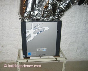

Ventilation: Venmar EKO 1.5 Energy Recovery Ventilator (ERV) located in the conditioned basement and ducted to central distribution system.
Energy recovery ventilator (ERV)

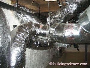

Space Conditioning Distribution: Heating, cooling and ventilation ductwork located entirely within the conditioned space.

Through both on-site and remote technical support, BSC was able to help the project identify feasible improvements and simplifications. Closed-cell spray foam was substituted for the open-cell at the sill in order to provide a drying mechanism for the framing. BSC eased the architect and builder into eliminating a planned drainage mat over the existing slab and at the new slab perimeter by demonstrating how rigid foam insulation against the rubble stone created a path to the drainage system. Despite generally excellent implementation of water management details, BSC was able to point out a few instances of missing flashing at critical locations.
