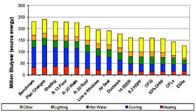

BSC recommended building upgrades that address energy efficiency, occupant comfort, affordability, sustainability, and durability. Key upgrades include an enclosure that is fully insulated and air-sealed with high density spray foam and supplemental dehumidification. Other upgrades that contributed to increased building efficiency and durability are state of the art LoE3 spectrally selective vinyl windows and a high efficiency HVAC system.

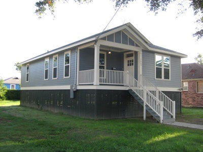

Description: A mix of 1,146 ft2 and 1,316 ft2 one-story single family detached homes

Estimated Annual Energy Savings: $750 to $1025 or an average 40% energy use reduction relative to the 2008 Building America benchmark

Parametric Study

This year, “Phase II”, is the construction of 12 detached single family homes in the same manner of construction as Phase I. The makeup of the team is the same as Phase I. This is a benefit in that the entire team is now familiar with all aspects of the house design. There are 3 floor plans that were designed by the local architecture firm FutureProof (http://www.futureproofnola.com/). The architect has provided an aesthetically pleasing mix of house designs that will fit well with the existing community. The floor plans are all single story with conditioned floor area ranging from 1146 ft2 to 1316 ft2. Please refer to the appendix for full floor plans. The builder for this project is TKTMJ, Inc. (http://tktmj.com/). All 12 homes will be occupied by low income families in need of a home after Hurricane Katrina.

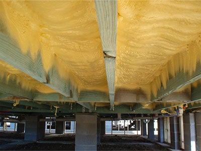

BSC provided consulting services for PHA and recommended numerous efficiency and durability improvements. Key upgrades include closed cell high density spray foam insulation for the entire enclosure (including an unvented cathedralized attic) and supplemental dehumidification. Other important upgrades include LoE3 glazing as well as a high efficiency heat pump.

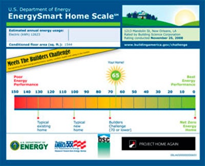

Project Home Again and BSC are working with a local rater who will provide the majority of the testing and building commissioning. They will not be Energy Star rated because of the additional cost concerns and the fact that they slightly missed the $2000 Federal Tax Credit. However, all these homes receive a HERS Index score that range from 66-69, therefore they qualify for Building America’s Builder’s Challenge certification.
Roof Assembly: The attic is unvented with high density spray foam installed under the roof deck. The unvented attic foam will be treated with an intumescent ignition barrier to meet the code fire protection requirement for an intermittently occupied space.

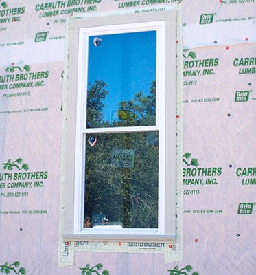

Window Specifications: The windows are vinyl with LoE3 spectrally selective glass that has a very low SHGC of 0.23. Glazing is the most important enclosure element in a hot-humid climate, and this next generation glazing technology is an impressive efficiency and durability upgrade.
Foundation Assembly: The homes will be fully framed and will be constructed on pressure treated wooden piles. Wooden piles were chosen for Phase II over the block piers utilized in Phase I due to the different soil geography in the neighborhood. All wood is borate pressure treated for resistance to termites and mold.

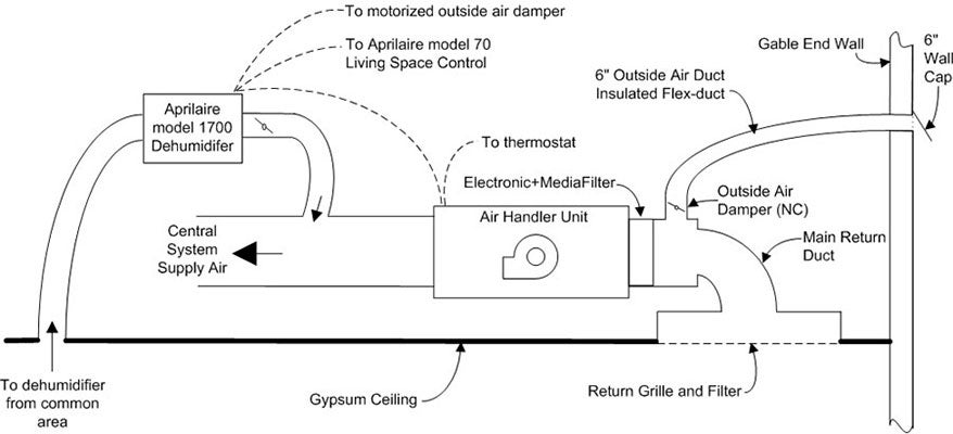

Ventilation: Central Fan Integrated Supply (CFIS) ventilation controlled by the Aprilaire dehumidifier. Ventilation is provided via a CFIS ventilation system that draws outside through a 6” flex duct to the return plenum of the HVAC system. This allows for the introduction of outside air to the living space whenever space conditioning is already operating.

Dehumidification: A whole house dehumidifier has been installed to allow for humidity control separate from cooling. This ensures proper comfort control year round. An Aprilaire Model 1750 whole house dehumidifier is configured to draw air from the main living space be distributed throughout the house and for the dehumidifier to run only when dehumidification is needed.
