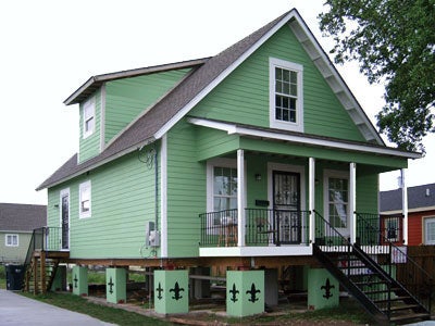

The Green Dream 1 house is a joint project between Catholic Charities Archdiocese New Orleans’ program Operation Helping Hands (OHH), the Louisiana State University AgCenter’s Louisiana House Project (LaHouse), and Building Science Corporation (BSC) working with the Department of Energy’s Building America Program.
The Green Dream 1 home has been built on property owned by the family before Hurricane Katrina. The property is located in the primarily residential St. Bernard planning district of New Orleans – below Lake Pontchartrain and near to City Park. The area is in a 130 mph wind zone and a hot-humid climate zone.

The proposed house is a 11/2 story, three bedroom single-family building on a raised pier foundation. The house design is similar to houses that have been built by BSC in many parts of the country.
The Green Dream 1 house is an example of best practice energy efficient and environmentally responsible homebuilding that is flood recoverable and affordable.
The Green Dream 1 prototype house was an effective demonstration of affordable, energy efficient construction approaching the target of 40% reduction in whole house energy savings relative to the Building America Benchmark. The estimated construction cost of $120 per square foot was only a marginal increase on the typical construction costs for this builder in this area. The increased capital expenditure on durability and energy efficiency measures was shown to be well within the dollar savings over the service life of the building created by reduced utility bills to the homeowner.

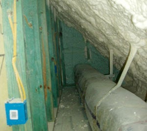

The attic is designed as an unvented attic, which can have superior performance for moisture control reasons, overall airtightness results, and moving the ductwork within the conditioned space. With unvented attics such as this, the plane of air tightness is located at the plane of roof, and not at the ceiling plane as is common with vented attic designs.

Roof Assembly: Rafter-framed unvented attic with R-33 roof insulation: 9.25” low-density spray foam in rafter bay, 1/2” treated plywood, fully-adhered membrane, high wind-rated asphalt shingles installed over the rafters, 1/2” paperless drywall installed below rafters.
Low-density spray foam in rafter bays

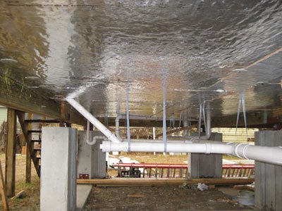

Foundation and Floor Assembly: Concrete grade beam and adjustable pier foundation, joist-framed floor on sill beam with R-13 floor insulation: 2” foil-faced polyisocyanurate insulating sheathing installed below floor joists (all joints taped to maintain air barrier), 1/2” fiber cement protection board installed below insulating sheathing.
Foil-faced polyisocyanurate installed below floor joists
