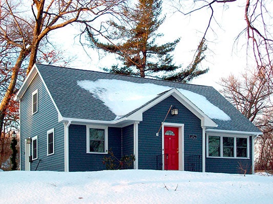

Location: Millbury, Massachusetts
Description: Exterior-only enclosure renovation of 11/2 story single family home with 1,100 ft2 living space and conditioned basement.
Completion Date: December 2010
Estimated Annual Energy Savings: Projected 58% energy use reduction compared to the pre-retrofit residence.
This Cape Cod style house was built in 1953. While the owners had made interior improvements and necessary repairs in the 25 years since they purchased the house, they now wanted to do some exterior upgrades and at the same time tighten up the house in keeping with their long-standing goal of becoming energy efficient and reducing their impact on the environment.

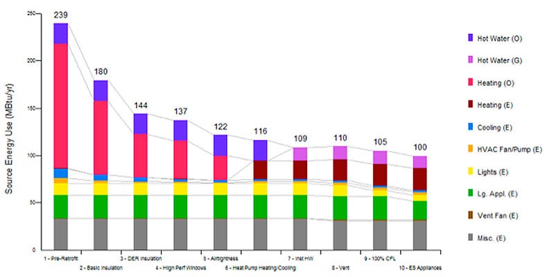

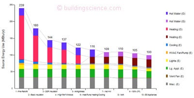

Parametric study image from BSC generated by NREL’s BEOpt 1.0 for retrofits

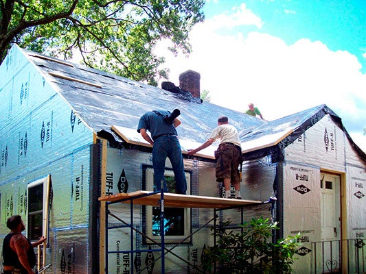

Roof Assembly: Compact (unvented) roof assembly with existing rafter bays filled with spray foam and with two 2” layers of foil-faced polyisocyanurate exterior insulating sheathing.

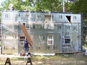

Adding insulating sheathing to roof
Wall Assembly: Existing wall framing cavities already contained batt insulation; two 2” layers of foil-faced polyisocyanurate exterior insulating sheathing were applied to the outside.

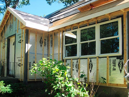

Insulating sheathing with taped joints and furring

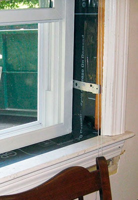

Window Specifications: New Paradigm triple glazed, argon-filled, low E double hung vinyl windows; U=0.25, SHGC=0.25.
Window installation
Infiltration: Self-adhering membrane over existing roof sheathing provides air control in field of roof; house wrap applied shingle style, with seams and edges taped, over the existing wall sheathing provides air control in the field of the wall; roofing membrane overlaps onto the house wrap to establish continuity of the air barrier system; air barrier system transitions through the mudsill to the spray foam insulation on the inside; this connects with the taped insulation board that is applied to the inside of the basement wall.

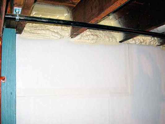

Foundation Assembly: Conditioned basement with 3” rigid polyisocyanurate insulation applied to the concrete foundation walls; to provide insulation for the concrete slab as well as provide some water management capacity, a drainage mat was placed over the existing slab, followed by polyethylene vapor barrier and then rigid insulation; a floating subfloor completes the new floor assembly.
Drainage mat and polyethylene vapor barrier at slab edge
The construction process for the above grade portion of the house was fairly straightforward, especially since the contractors were experienced with applying exterior insulating sheathing in other projects. Since the existing house had no overhangs and was of a compact form, once the siding and shingles were stripped off of the board sheathing, it didn’t take long before the house looked like a box wrapped in “a blanket of insulation” as described by the owner. There was a delay, however, when some significant water damage was discovered after the siding was removed. The repairs, along with the new overhangs that provide a robust water management system, will ensure the durability of the wall structure.

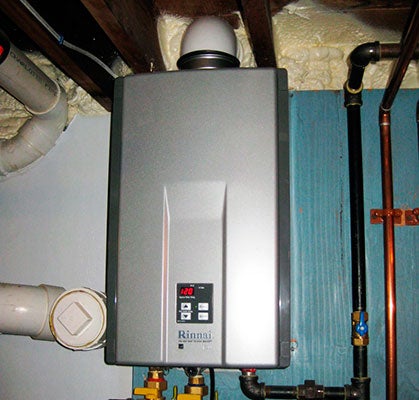

DHW: Instantaneous propane water heater.
Domestic hot water heater
