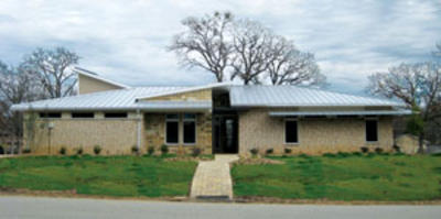

Project Team: Greencraft Builders, LLC, Building Science Corporation
Location: Lewisville, Texas
Description: 2,409 ft2 one-story single family home
Completion Date: November, 2009
Estimated Annual Energy Savings: Average 53% projected source energy savings relative to the 2009 Building America Benchmark
Project Website: http://timbercreekzeroenergyhouse.com/index.html
BSC collaborated with Greencraft Builders in Lewisville, TX on a 2009 prototype house called the TimberCreek Net Zero Energy House. This house demonstrates the energy efficiency and durability upgrades that Greencraft has been promoting for years. The architect for the TimberCreek Net Zero Energy House was William Peck and Associates, out of Lewisville, TX. The TimberCreek Net Zero Energy House is located in Lewisville, TX.
This was Greencraft Builder’s first attempt at a Zero Energy house. The strategy for achieving zero net energy was to lower building consumption through a high efficiency enclosure and mechanical as much as possible and follow up with a photovoltaic installation to generate the remaining amount of energy needed to operate the building over the course of a year.

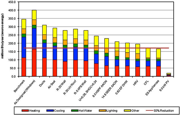

Parametric Study

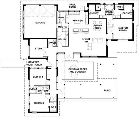

Floor plan

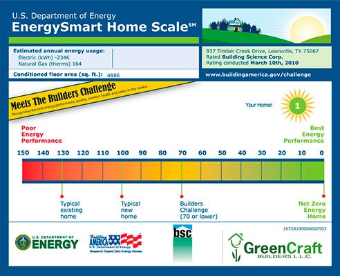

Builders Challenge certificate

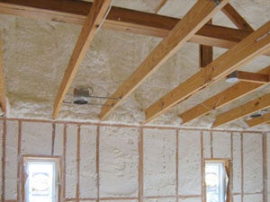

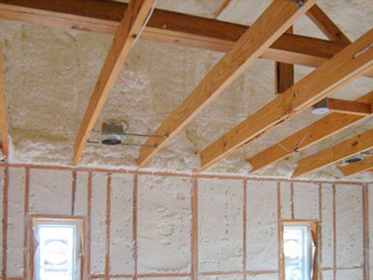

Roof Insulation: Unvented roof with 8.5” R-30 open cell spray foam and fully adhered waterproofing membrane under a standing seam metal roof.
Open cell spray foam in unvented roof

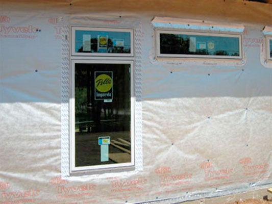

Window Specifications: Fiberglass framed LoE3 double glazed windows: U=0.28, SHGC=0.22.
Windows installed and flashed
Air Sealing: The design infiltration rate is 2.5 in2 leakage area 100 ft2 of enclosure area. Low density open cell spray foam installed in wall and roof cavities. Low expanding open cell spray foam installed around windows and mechanical and electrical penetrations throughout the enclosure.
Installing low density open cell spray foa

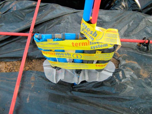

Foundation Assembly: Slab-on-grade foundation; uninsulated with Termimesh® termite mitigation system and sill gasket between framed wall and slab.
Termimesh® installed

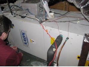

One of the major design upgrades for this house will be the installation of a heat pump with integrated supplemental dehumidification. AAON Inc. has designed a residential heat pump that integrates a modulating gas reheat coil to allow for dehumidification separate from cooling. This technology has been implemented successfully in commercial buildings for years and now will provide supplemental dehumidification in residential buildings.

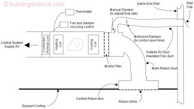

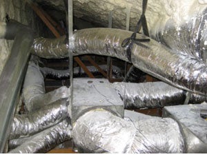

The entire duct system is located in the unvented conditioned attic is sealed extremely tight. Jump ducts provide passive returns from the bedrooms. High efficiency exhaust ducts are installed at all the bathrooms and at the kitchen hood.
Heating: 8.5 HSPF heat pump
Mechanical system design schematic

Supplemental Dehumidification: Modulating hot gas reheat coil added to air handler to allow for dehumidification separate from cooling.
Dehumidification system installed

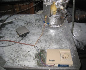

Ventilation: Central Fan Integrated Supply Ventilation controlled by Aprilaire 8126 Ventilation Control System (VCS).
Aprilaire VCS controller and motorized damper

Ducts: R-8 flex ducts in unvented conditioned attic; leak free to outside (5% or less)
Ducts in unvented conditioned attic

Greencraft Builders, LLC utilizes Central Fan Integrated Supply ventilation that draws outside air via a 6” flex duct to the return plenum of the HVAC system. This allows for the introduction of outside air to the living space whenever space conditioning is already operating. An Aprilaire® Ventilation Control System 8126 communicates with the air handler to employ fan cycling. Fan cycling will turn on the fan at a 33% duty cycle (10 minutes on, 20 minutes off) in order to provide outside air during periods of no space conditioning. A 6” mechanical damper is installed on the 6” outside air duct. This is controlled by the fan cycler and will close off the outside air duct during periods of consistent space conditioning to prevent over ventilation of the living space.
Bathroom exhaust fans plus a kitchen hood are installed to provide spot ventilation when necessary. These are all routed to the outside and are not re-circulating fans. One of the bathroom fans is rated to provide ASHRAE 62.2 ventilation so that the house can be operated at that rate if needed.

  • Better controls and controls on heat pumps: The heat pump malfunctioned a number of times during the commissioning of the house. Various problems such as compressor relay failure and refrigerant leak delayed progress of the house greatly. Failure Detection and Diagnostic (FDD) mandates are greatly needed on heat pumps as their controls are becoming increasingly more complicated. Properly designed FDD sensors will greatly improve efficiency over time at a small net cost per unit. BSC has been communicating this request directly to the industry.
  • High energy use during space conditioning: There was also a design fault on the heat pump that was resulting in around 300W more fan energy use during operation. This was due to the presence of a circuit mounting bracket in the air handler that is blocking flow. The bracket was from another design and was not removed during the design of the air handler. AAON was able to remove the bracket and will ensure that future units will be designed properly.
Percent Energy Use Reduction
47
Building Enclosure, Windows,
