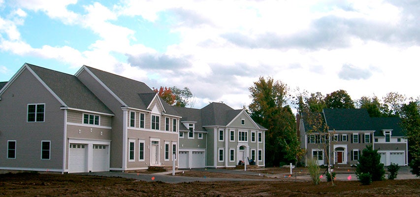

Project Team: C. Nelson Construction, Inc.
Location: Hamilton Way, Farmington, Connecticut
Description: 10 single family 4-bedroom homes with basements ranging from 3,000 ft2 to 3,700 ft2
Completion Date: February 2009

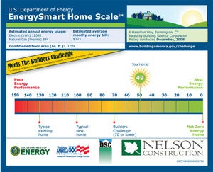

Estimated Annual Energy Savings: 50% savings over the Building America benchmark; $2,600 to $3,800

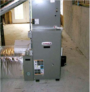

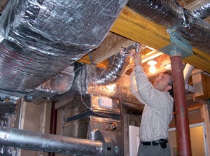

In the heating dominated climate a high efficiency natural gas furnace (94% AFUE) was included in the design, along with a 14 SEER air conditioner and an instantaneous gas domestic hot water heater. As a cost savings and system efficiency measure, the mechanical design was modified from 2 furnace air handlers (one in the attic and one in the basement) to a single furnace air handler in the basement with 2 zones. This removed all of the ductwork from the attic and placed it within the conditioned space. The house plans were modified to reroute the ductwork in the structure to provide conditioning to the second floor. This required a few framing modifications and the addition of some dropped soffits to accommodate the supply trunks. To provide better mixing of the interior air, two returns were designed into the system (low on the first floor and high on the second floor). The intent was to help counter the effects of stratification. These efforts were successful in bringing all of the ductwork inside the conditioned space.

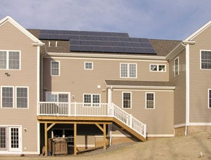

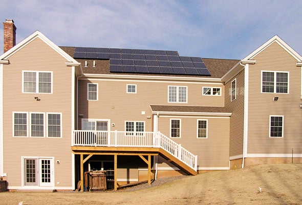

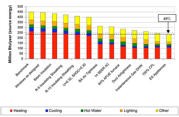

All of these strategies were modeled through a parametric annual load study that examined the individual effect of each strategy as well as the total cumulative effect of all of the strategies. The results of the analysis indicated that the homes would well exceed the Building America minimum target and achieve a source energy consumption reduction between 45% and 48%. These efficiency goals were achieved entirely from energy consumption reduction strategies and not through the addition of renewable strategies to offset energy use. However, photovoltaic panels were offered by Nelson Construction as an option and are being installed on a few homes in the community.

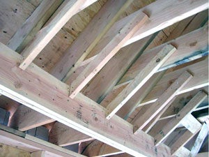

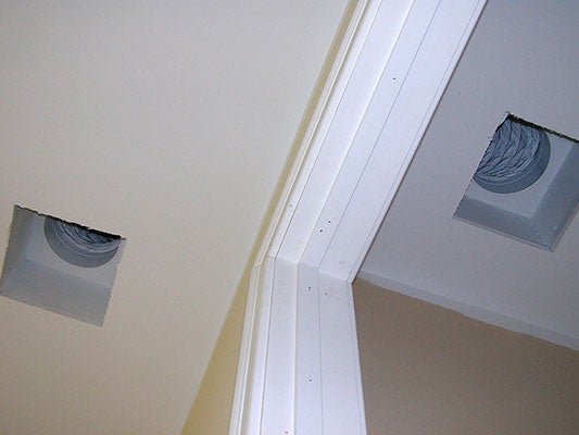

Roof Assembly: Rafter framed vented attic with R-50 blown cellulose insulation. Dropped perimeter ceiling soffits were used to maintain the thickness of the insulation near the perimeter and still be able to provide higher ceilings in areas such as the master bedroom.
Dropped soffit at ceiling perimeter

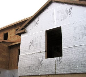

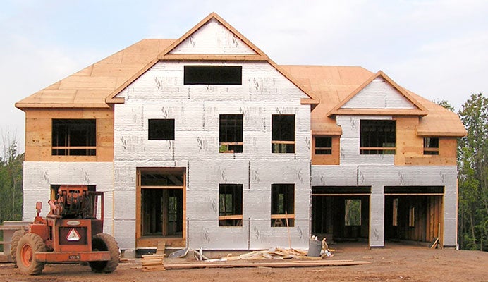

Wall Assembly: 2x6 wall at 24” O.C. with R-19 damp spray cellulose cavity insulation and 2” (R-13) of foil-faced polyisocyanurate insulating sheathing. The wall drainage plane was provided by Tyvek homewrap installed over the insulating sheathing.
Two-inch foil-faced polyisocyanurate insulating sheathing

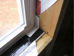

Window Specifications: Harvey Vicon double hung vinyl Low-E Argon with contour grid windows (U=0.32, SHGC = 0.27). Windows were installed in a pan flashed and drained manner with a sloped sill drained to the exterior and the head and jambs integrated into the drainage plane through the use membrane flashing.
Window pan flashing from interior

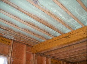

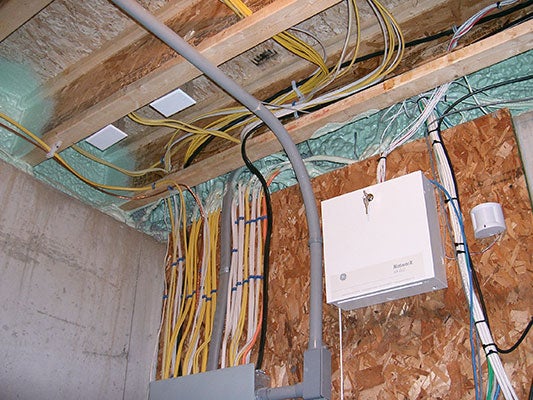

Floor Assembly: TJI floor framing with 1” closed cell spray foam flash seal with the remaining cavity filled with fiberglass batts.
Floor framing with closed cell spray foam

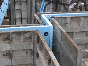

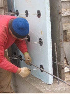

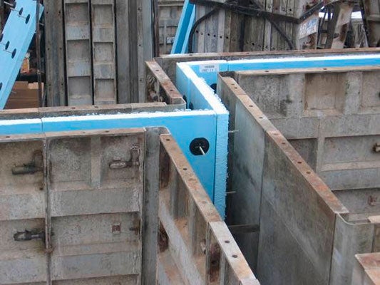

Foundation Assembly: Conditioned basement with 2” (R-10) XPS cast into 10” concrete walls (Thermomass® System). 2” (R-10) XPS insulation installed below the concrete slab.

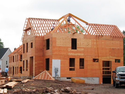

The construction of the subdivision took place from January 2008 with final build out in March 2009.
Heating: 94% AFUE sealed combustion gas furnace in conditioned space
Cooling: 14 SEER split system air conditioning

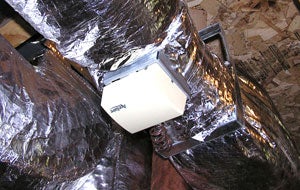

Ventilation: Central fan integrated supply (CFIS) only ventilation operated with Aprilaire controller.

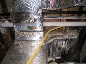

Space Conditioning Distribution: Single air handler furnace with zone controlled dampers (zone 1: first floor and basement, zone 2: second floor). Insulated sheet metal trunks with insulated flex run-outs. Two ducted returns (first and second floor), with jump ducts/transfer grilles at bedrooms. Filter minimum MERV 12.

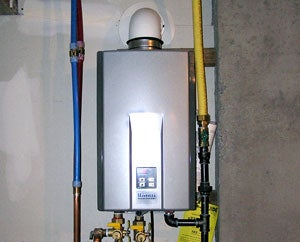

DHW: 0.82 EF instantaneous gas water heater
Instantaneous gas water heater

Site Generated Power: Optional photovoltaic system offered by builder.

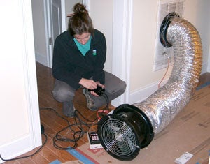

Over the course of construction BSC tested the homes as they were completed to ensure that the actual performance of the homes is meeting the predicted minimum performance targets of the Building America Program.
As part of the testing requirement, each home was blower door tested to measure the air tightness of the enclosure. All of the homes tested approximately 25% below the maximum air leakage threshold set out in the Building America program.
In addition to overall air tightness, the mechanical systems were also tested to measure the potential duct leakage to the outside. Since the design moved all of the ducts inside the conditioned space, the leakage to outside was also below the maximum threshold target.
The measured performance values were input into the energy models and final simulations were completed. Based on the actual measured performance of the homes, the estimated source energy consumption reduction was over 50% for every home (some as high as 55%) when compared to the Building America benchmark protocol.
Nelson Construction is working with the homeowners in order to collect utility bills over the next year or more. These bills will be examined and compared to the predicted use of the energy model.
