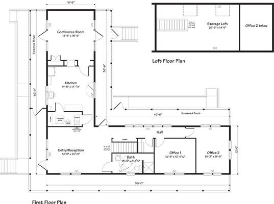

Although most people associate the term zero energy with solar panels, the starting point must always be the efficiency of the structure and its heating/ventilation/air conditioning (HVAC) system. The way to really fine-tune the energy performance of a building is to treat the structure andthe HVAC system as integrated systems, matching their features and individual contributions to the whole.

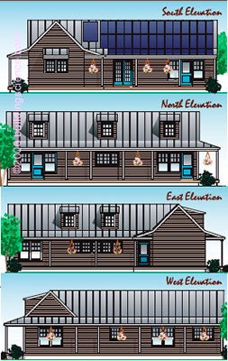

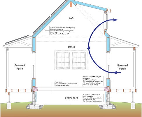

- deep wrap-around porches and window awnings for maximum shading and lots of indirect daylighting;
- number and location of operable windows (for cross ventilation) and high ceilings (for stack effect ventilation);
- highly reflective white standing seam metal roof cladding. These all work to reduce the need for mechanical cooling and electric lighting.
2. The HVAC system – Building a high-performance structure allows you to really fine tune or “right-size” your space heating and cooling unit, your fresh-air ventilation, and the ducts that deliver all three. Essential elements to the Administration Building include a variable-speed ECM air handler, a two-stage 13.25 SEER/8.95 HSPF heat pump unit, and a scheduled intermittent out-side air ventilation system that also provides mixing of all interior air. Mechanical ventilation, you say? You can’t build this tight and not purposefully introduce the outside air you need.

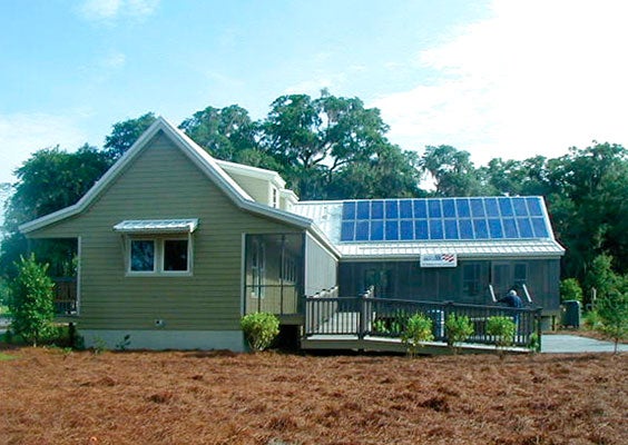

For the Suwannee River Administration Building of 1,700 square feet with astaff of three to four people, a 4.1-kilowattsystem with 40 EC-102 panels will supply nearly all of the building’s electrical needs. Like most PV systems, the Suwannee River PV system costs about $6 per watt. But the system will continue generating power with little to no replacement for many years.
