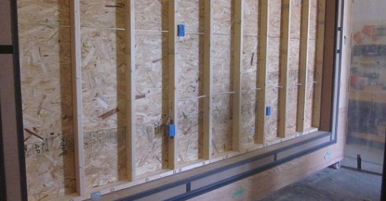

Figure 1: Thermal Metric test wall during construction
Figure 1: Test Wall Construction

The following process depicts a normal construction process for a 2x4 framed test wall.
  1. Framing materials are chosen from a selection of moisture content equilibrated framing lumber of similar average densities.
  2. The 95 in x 143 1/8 in (2410 mm x 3635 mm) stud wall is framed on a level surface without affixing the sheathing.
  3. Two heavy beads of removable caulking are placed on the cartridge below the location of the bottom plate for air sealing purposes.
  4. The wall is lifted into place, squared and shimmed to match the cartridge frame, and held in place with clamps at a depth that allows the OSB to be installed flush with the front of the cartridge.
  5. 7/16 in (11 mm) OSB sheets are installed horizontally and offset by four feet using shims at the top and bottom plate to create gaps at each fastener. Sheathing is then affixed according to the recommendations made in the APA Engineered Wood Construction Guide.
  6. Two electrical outlets and a switch are installed as per standard practice.
  7. Backer rod and sealant are installed on the left, right, and top of the wall to complete the wall-to-cartridge air sealing.
  8. Insulation is installed as per manufacturer’s recommendations.
  9. Interior gypsum wall board is installed on the interior surface using shims at the top and bottom plate to create gaps at each fastener.
  10. Building wrap is installed over the exterior OSB as per the manufacturer’s recommendations.
  11. The vertical edges of the building wrap are taped to the cartridge.
  12. 4 in (100 mm) vinyl siding is installed as per the Vinyl Siding Installation Manual.
  13. The interior and exterior surface thermistor arrays are installed and tested.
  14. The wall system is inspected and photographed.
  15. The cartridge containing the wall is installed into the test box.
  16. An air leakage test is performed before testing commences.

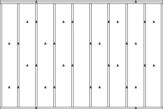

Paired temperature measurements are made on opposite sides of the test specimen using calibrated thermistors. The sensor locations on the meter box side are replicated identically on the climate box side, such that each location has a sensor on either side of the wall sample. The thermistors are attached directly to the surface of the specimen using a three layer taping assembly. Two layers of aluminum tape sandwich the sensor and are used to average the local temperatures. A mat-black top tape layer is used to cover the reflective foil tape to create a radiatively homogeneous surface. Figure 2 shows an instrumentation grid typical of the test walls. Stud, stud bay, and top and bottom plate temperatures, and hence temperature differentials, are measured.
Figure 2: Typical temperature measurement locations for test walls
Figure 1: Temperature Measurement Locations for TM Test Walls
