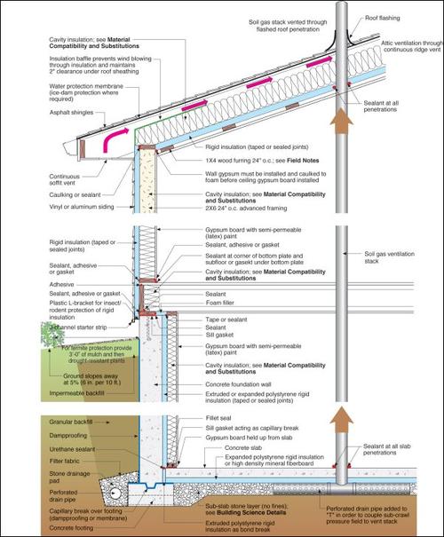

This one-story enclosure with a basement is designed for Louisville, KY (Mixed-Humid Climate). It features a vented roof with cavity insulation in rafter cavities and rigid insulation at the underside of the rafters, and asphalt shingles. The 2x6 advanced wood frame walls are insulated with cavity insulation and rigid insulation on the exterior of wall sheathing. The rim joist is insulated with cavity insulation on the interior. The foundation wall is insulated with XPS or EPS rigid insulation on the interior along with cavity insulation in a wood stud wall. EPS rigid insulation or high density mineral fiberboard is installed under the foundation slab.

  • Cathedral roof assembly – The continuous eave-to-ridge venting just to the inside of the structural roof deck serves to thermally decouple everything to the exterior of this air space from everything to its interior (sometimes called a “cold” roof). It is the continuity of the air space, the thermal barrier, and the air barrier that makes this roof assembly work.

  • Drainage plane, air barrier, vapor control – The drainage plane runs along the exterior surface of the foam sheathing. All vertical joints must be shiplapped, flashed, or sealed; all horizontal joints must be sealed or taped.
    This building profile has a continuous air barrier on the (Airtight Drywall Approach on ceiling and walls; see Air Sealing / Air Drywall Approach Details) and on the exterior walls (the sealed rigid insulation).

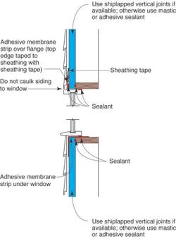

  • Rough opening flashing Flashing is always installed in the plane of drainage for continuity; this means that when a different material or “layer” makes up the drainage plane, window flashing details move accordingly. See Figure 18 and theWater Management Guide for sequential flashing details.

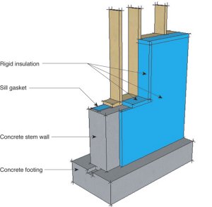

  • Framing on slabs – Installing a capillary break between the sill plate and a concrete slab on all walls—exterior, interior, partition—is good practice. A closed cell foam sill sealer or gasket works well. Alternatively, a strip of sheet polyethylene can be used. This isolates the framing from any source of moisture that may be either in or on the concrete slab. Using sill sealer on all walls maintains the same wall height.
  • Soil gas ventilation The sub-slab to roof vent system handles conditions that are difficult if not impossible to assess prior to completion of the structure—resultant confined concentrations of air-borne radon, soil treatments (termiticides, pesticides) methane, etc. The cost of this “ounce” of prevention is well balanced against the cost of the “pound” of cure.
  • Sub-slab stone bed - The four-inch deep, 3/4-inch stone bed functions as a granular capillary break, a drainage pad, and a sub-slab air pressure field extender for the soil gas ventilation system. Without it, a soil gas ventilation system is not practically possible and the only capillary break between the slab and ground is the polyethylene vapor barrier.
  • Thermal barrier – Cavity-warming exterior rigid insulation is important in this climate where the average monthly temperature for the coldest month of the year goes below 45°F. See Unvented Roofs for more information. The rule of thumb that BSC uses is 1/4-inch of rigid insulation per 1,000 heating degree days (HDD); one inch of rigid insulation works well for this climate. The heat loss through the crawlspace walls is significant enough to warrant insulation. Note that the insulation must comply with local codes for protection against ignition.
  • Basement and slab insulation – Although the basement walls and basement slab as shown clearly go beyond what is required by any code for this climate, this assembly assumes that the basement either is or will become a living space. It is not, however, the energy performance that is driving this design, but rather occupant comfort, dust mite control, and reduced potential for moisture problems that justifies the added cost of the assembly’s insulation. See the BSC technical resource, Basement Insulation Systems, for other basement wall assemblies that work.
  • Foundation sealant details – Note that the inside bead of sealant or caulk is an air sealing detail. The sealant between the two sheets of rigid insulation is actually a seal against insect and soil gas infiltration—this calls for a chemical bonding that can be accomplished with 2-part urethane.

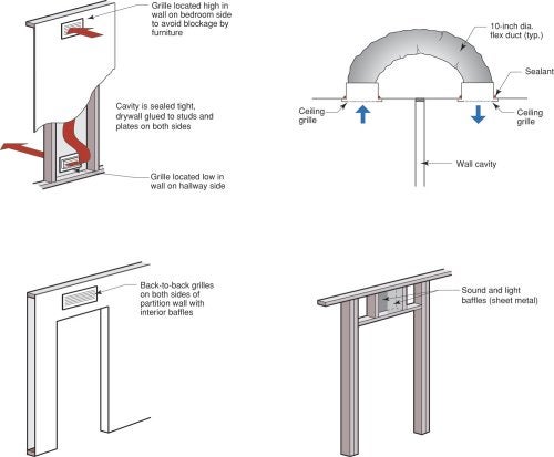

    • Heating and Cooling – Recommend a sealed combustion gas furnace - for energy efficiency and health/safety with the unit inside conditioned space (The “Louisville”—just under 5,000 heating degree days—is just about at the margin of heat pump winter-time efficiency; hence the recommendation for a gas heating and separate electric cooling system). Recommend a minimum 12 SEER AC unit - for energy efficient management of sensible load. See figures below. Follow appropriate sizing procedures—see the Cooling System Sizing Procedures for more detailed information.
    • Ducting - Single return requires transfer grilles to provide path and avoid pressurizing bedrooms as shown in Figures 19a-d.
Figure 19a-d

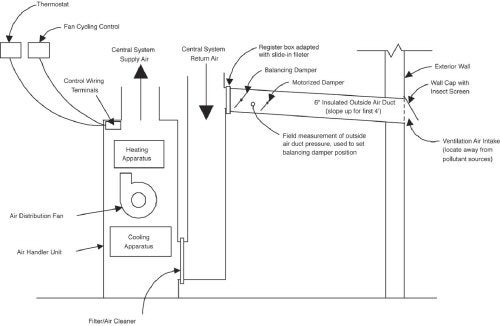

  • Mechanical ventilation
    • Intermittent central-fan-integrated supply, designed to ASHRAE 62.2 rate, with fan cycling control set to operate the central air handler as much as 33% of the time, but not less than 25% of the time, occurring within at least every three hours to provide ventilation air distribution and whole-house averaging of air quality and comfort conditions ($125 to $150). Optionally include a normally closed motorized damper in the outside air duct with the AirCycler® FRV control (+$50 to $60). Optional dehumidification separate from cooling (+$300 to $350). See Figures 20, 21 and 22.

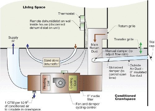

  • Supplemental dehumidification - Although high performance homes in this climate rarely require supplemental dehumidification, it is:
    … one of three strategies appropriate for conditioned crawlspaces (see Building Science Notes),
    … may be desired in homes with full basement foundations, and,
    … is strongly recommended when occupants require humidity control (and high-efficiency air filtration) for asthma trigger control.
    There are a number of different ways to accomplish supplemental dehumidification with varying costs and performance advantages (for a detailed discussion of supplemental dehumidification see Conditioning Air). Described below is one low-cost yet effective approach and one more costly but higher performance/systems-engineered approach:
    1. Ducted stand-alone dehumidifier: This system is a "site-constructed" one consisting of an off-the-shelf standard dehumidifier ducted in the attic and controlled by a dehumidistat located in the living space. This arrangement of individual components has proven to be an effective and economical system for the production home building setting. The installed cost ranges from approximately $350 to $550. The system is comprised of a GE dehumidifier model AHG40FCG1 (dehumidifier located in attic in an insulated enclosure and ducted to living space), Honeywell dehumidistat model H8808C located in living space, and Honeywell switching relay (with transformer) model RA89A 1074. See Figure 22a. The selection of the dehumidifier is based largely on the fact that it has a blower wheel rather than paddle fan that moves air more efficiently in its ducted box configuration.

  • Flashing details – Since the vinyl siding is a screened wall cladding system, flashing details should be accomplished in the plane of drainage (building paper or house wrap), not the cladding. Do not caulk siding and do not rely on "J"-channel as part of the drainage plane. (In other words, never consider vinyl siding, aluminum siding or any siding, for that matter--as the weather barrier).

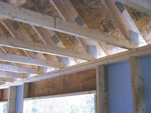

  • Energy trusses – There are a number of different truss configurations that yield greater depth at the heel, but they vary quite a bit in cost. The truss shown here (sometimes called a “slider” truss) has proven to be among the most cost-competitive (see Figure 23). And of course, the pitch of the roof affects just how much insulation you can get at this location, regardless of the type of truss.
