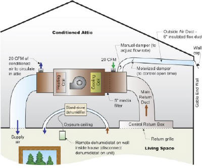

  • Mechanical ventilation
    Figures 3a-d
  • Heating and Cooling – Sealed combustion hot air furnace; SEER 12 air conditioning unit. A single return requires transfer grilles to provide return path and avoid pressurizing bedrooms (see Figures 3a-d).
  • Ventilation -
    For homes with central forced air distribution system:
    Intermittent central-fan-integrated supply, designed to ASHRAE 62.2P rate, with fan cycling control set to operate the central air handler as much as 33% of the time, but not less than 25% of the time, occurring within at least every three hours to provide ventilation air distribution and whole-house averaging of air quality and comfort conditions ($125 to $150). Outside air fraction is designed to keep mixed air temperature at furnace heat exchanger above 50°F, usually not more than a 10% outside air fraction. Optionally include a normally closed motorized damper in the outside air duct (+$50 to $60). See Figures 4, 5 and 6.
    In very cold climates ventilation can also be accomplished using a continuous single-point exhaust system, designed to ASHRAE 62.2P rate, pulling from the principal living area ($150).
    For homes without central forced air distribution system:
    Continuous multi-point exhaust, designed to ASHRAE 62.2P rate, pulling from each bedroom, unless the bedroom has a bathroom then it will pull from the bathroom, and pulling from at least one location in the principal living area. Any combustion appliances must be direct-vent sealed combustion.

  • Supplemental dehumidification - Although high performance homes in this climate rarely require supplemental dehumidification, it is:
    … one of three strategies appropriate for conditioned crawlspaces (see Building Science Notes),
    … may be desired in homes with full basement foundations, and,
    … is strongly recommended when occupants require humidity control (and high-efficiency air filtration) for asthma trigger control.
    There are a number of different ways to accomplish supplemental dehumidification with varying costs and performance advantages (for a detailed discussion of supplemental dehumidification see Conditioning Air). Described below is one low-cost yet effective approach and one more costly but higher performance/systems-engineered approach:
         1. Ducted stand-alone dehumidifier:
    This system is a "site-constructed" one consisting of an off-the-shelf standard dehumidifier ducted in the attic and controlled by a dehumidistat located in the living space. This arrangement of individual components has proven to be an effective and economical system for the production home building setting. The installed cost ranges from approximately $350 to $550. The system is comprised of a GE dehumidifier model AHG40FCG1 (dehumidifier located in attic in an insulated enclosure and ducted to living space), Honeywell dehumidistat model H8808C located in living space, and Honeywell switching relay (with transformer) model RA89A 1074. See Figure 6a. The selection of the dehumidifier is based largely on the fact that it has a blower wheel rather than paddle fan that moves air more efficiently in its ducted box configuration.
