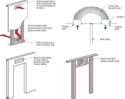

      • A sealed combustion hot air furnace. A single central return requires transfer grilles to provide return path and avoid pressurizing bedrooms (see Figures 3a-d).
      • Continuous multi-point exhaust, designed to ASHRAE 62.2P rate, pulling from each bedroom, unless the bedroom has a bathroom then it will pull from the bathroom, and pulling from at least one location in the principal living area. A fan-cycling control for the central air handler provides mixing only. Any combustion appliances must be powerdirect vented sealed combustion.
Figure 3a-d

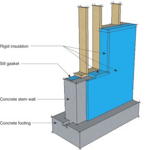

  • Stepped foundation insulation detail – Maintaining thermal barrier continuity in stepped foundations has proven difficult or easy to neglect. Figure 6 shows how the rigid foam needs to be cut and placed.
Figure 6

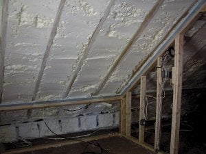

  • Eave insulation – the spray foam insulation stop between rafters in the roof assembly can be either blocking (see Figure 7) or rigid insulation from the wall cut out to extend up and between each rafter.
Figure 7

  • Cavity insulation in the unvented roof assembly – There are essentially four ways to manage heat, air, and moisture flow in an unvented roof assembly in very cold climates:
    NOTE: only the fourth option can involve cavity fill insulation other than spray foam—spray foam is the only uniform, air-impermeable cavity fill insulation appropriate for the first three options.
    • Fill the entire framing cavity with low-density spray foam insulation and install 1-inch rigid foam insulation to the interior of the framing. In this case, the spray foam insulation effectively moves the first condensing surface to the inside of the assembly, and the rigid insulation both protects thermal bridging and condensation potential at the rafters and lowers the permeability of the interior of the system (open cell spray foam being about 10 perms and 1-inch of XPS rigid foam insulation being about 1 perm). This system is best suited for rafter framing and is the system shown in this building profile.
    • Install spray foam insulation to the depth desired or required for R-value and, after the foam has cured, cover the inside surface of the spray foam with either latex paint or (if code considerations require a system of protection against combustion) install gypsum board painted with latex paint. This system moves the first condensing surface to the inside face of the cavity insulation and is best suited for roof truss framing because the spray foam depth encapsulates all roof framing (except portions of the webs). See the “Boston” building profile.
    • Install high-density spray foam as the cavity insulation. Its vapor permeability is low enough that no latex paint coating is required, although gypsum wallboard or fiberglass insulation with foil facing may be required for code compliance (See the "Boston" building profile).
    • Install enough rigid insulation to the exterior of the structural system (roof sheathing and framing) to warm the structural system and prevent condensation (the first condensing surface is the exterior surface of the structural roof sheathing). The general rule of thumb is 1-4-inch of rigid foam per 1,000 heating degree days (but this rule involves the interior conditions as well—interior relative humidity during the coldest months affects the level of exterior rigid insulation required to manage condensation). In very cold climates, this involves deep enough rigid insulation to require another layer of sheathing on the exterior of the insulation to act as the nailing base for the roof cladding. This system works for any type of roof framing system but is not very common because of relative first cost
