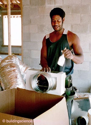

In what has become an amazing turn of events folks are figuring out how to construct tight ducts—even when they are located “inside”. Mastic rules (Photograph 1). All of this is good. The only place air should exit a duct or enter a duct is at a grille or register. So what is the problem?
Photograph 1—Mastic Rules: I did not think I would live to see the day where mastic is used to seal all ductwork not just ductwork outside the conditioned space. Woo-hoo!

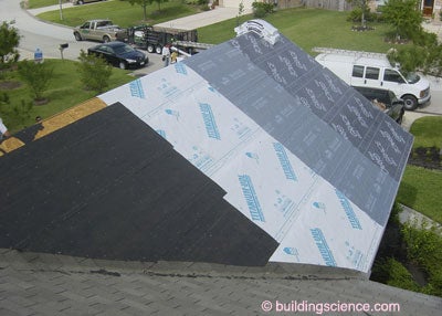

What was significant about the communication? The air change provided a means of removing moisture that found its way into the attic space. Where did the moisture come from? Mostly from inside and from air change (Figure 2a and Figure 2b). It did not come through the roof shingles—despite what I thought a decade ago (Photograph 2, Photograph 3 and Photograph 4).
Photograph 2—Test Attic in Houston: To this day I am amazed at what builders are willing to do to figure stuff out. David Weekley Homes said “sure” we will let you have one of our garage attics for a year on one of our sales models if you figure out if stuff from outside is being driven inside. Hat tip to Mr. Weekley. I was worried that moisture from dew and rain would wick into the overlaps of asphalt shingles and be driven inwards by solar radiation and lead to increased moisture contents in roof sheathing—especially in unvented roof assemblies—turned out I was wrong.
Photograph 3—Permeable and Impermeable Roofing Underlayments: Turned out that there was no measurable effect of roofing underlayment permeability on inward moisture drive through the roofing assembly.
