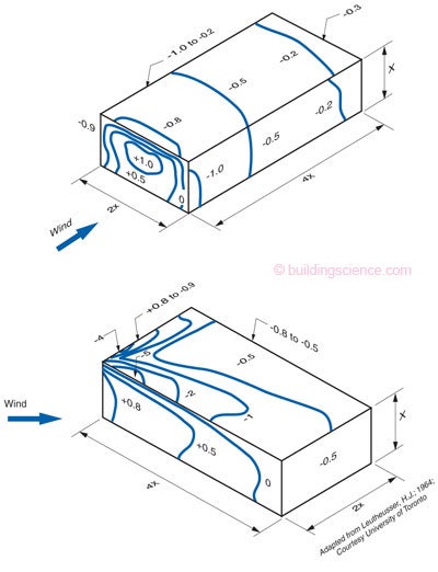

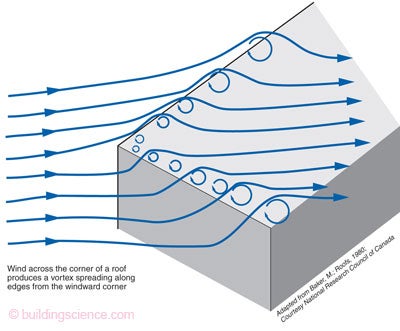

When wind blows against a building it produces vortices at the roof edges (Figure 1) that create huge pressure differences (Figure 2) at roof perimeters that can suck roofs off buildings. Parapets dramatically reduce these pressure differences at roof edges (Figure 3). Neat eh? All this from a University of Toronto guy, go Varsity Blues (Leutheusser, H.J., 1964(2)).
Figure 1: Roof Edge Wind Effects
—When wind blows against a building, it produces vortices at the roof edges.
Figure 2: Pressure Difference
s—Notice the large pressures at roof perimeters. From Leutheusser(2) and the Department of Mechanical Engineering, University of Toronto, 1964. Some of us recall that 1964 was a good year. The Toronto Maple Leafs won the Stanley Cup. Tim Horton played defense on that team long before he got into the donut business.

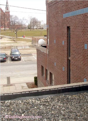

The easiest thing to get right about parapet construction is to keep rainwater from getting into the top of them. The principles are easy. Slope the top of them inward so they don’t stain the building façade. Make sure that there is a waterproof membrane under the coping. Always. Metal and stone copings leak at joints. And always have drip edges—front and back—so that they don’t stain the building façade. Did I mention the staining of the building façade? Check out Figure 4 and Photograph 1 to see it done right. If you want to get depressed, look at Photograph 2.
Figure 4: Parapet Water Management
—Keep rainwater from getting into the top of them. Slope the top of them inward so they don’t stain the building façade. Make sure there is a waterproof membrane under the coping. And always have drip edges—front and back—so they don’t stain the building façade.
Photograph 1: Excellent Water Managemen
t—Notice the membrane under the coping. Notice the slope to the interior. And, notice the drip edges.

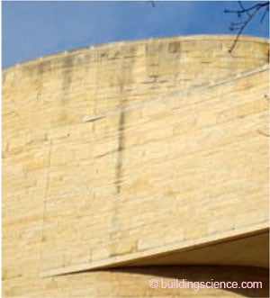

Photograph 2: Stains at Parapet
—No drip edges. A beautiful building is becoming ugly.

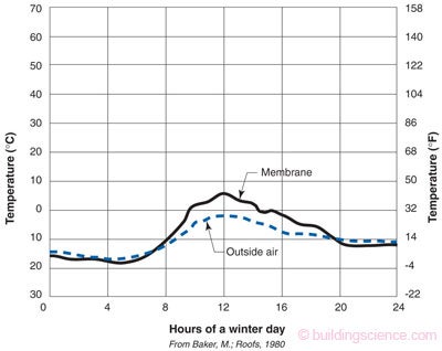

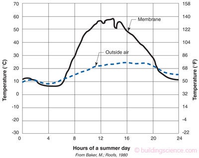

And to make matters worse, structurally we also tend to have some issues. Ah, but not in the way you think. Think about the thermal stress a roof membrane goes through (Figures 7 and 8). The key is to transfer these stresses to the roof deck. In the old days it was easy; just fully adhere the roof membrane with a lot of goop directly to the structural deck so that each square foot of roof membrane stress was directly transferred to the square foot of structural deck directly under the membrane. No problem. Until, wait for it, some lunatic person introduced thermal insulation. Now we had to transfer the stress of the membrane through sometimes multiple layers of insulation before it got to the structural deck (Figure 9). If you didn’t get it right, you concentrated the stresses at roof edges, and you could suck in a parapet (Figure 10) or tear or rip a membrane at the parapet (Photographs 3 and 4).
Figure 7: Roof Membrane Temperatures
—Ottawa, Canada, summer day. Courtesy of Max Baker and the National Research Council of Canada.(1)
Figure 8: Roof Membrane Temperatures
—Ottawa, Canada, winter day. Courtesy of Max Baker and the National Research Council of Canada.(1)

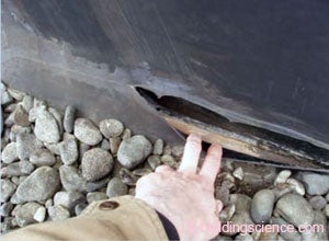

Photograph 3: Membrane Shrinkag
e—Notice the roofing membrane being pulled away from the cant strip.
graph 4: Tear in Membrane—Membrane shrinkage results in the membrane pulling apart.

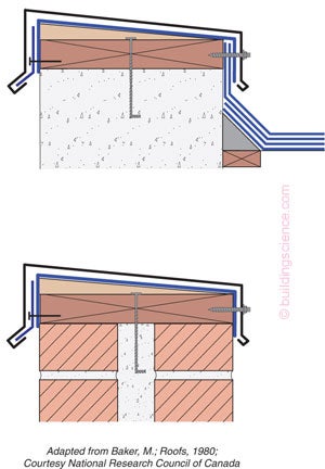

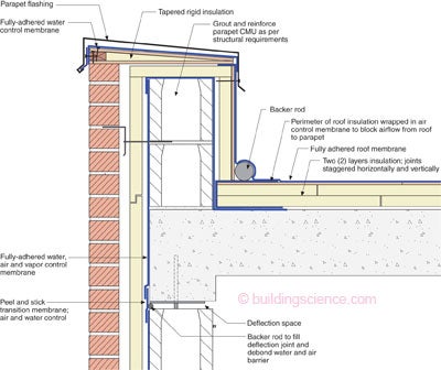

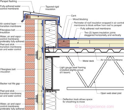

Next we have to deal with the potential for concentrated roof stresses at parapets. Figure 12a shows how the “old timers” did it—wood blocking and a cant anchored to the structural deck. Figure 12b shows how the “new pups” do it—a large backer rod supporting a bunch of extra membrane that lets things move when they have to move. As much as it pains this “old timer” to say this, with the newer more dimensionally stable membranes the “new pups” have it more right.
Figure 12a: Steel Stud Parapet “Old Timer.”
—Wood blocking and a cant anchored to the structural deck restrain membrane shrinkage at parapet. Notice the continuity of the control layers.
Figure 12b: Steel Stud Parapet “New Pups.”
— Large backer rod supporting a bunch of extra membrane that lets things move when they have to move. The “Zen” approach to membrane movement. Use a more dimensionally stable membrane and then let things move when they have to. Again, notice the continuity of the control layers.
Now on to the continuity stuff. All we have to do is apply the Baker Principles (Figure 5) to typical roofs and walls. To that end, with the help of my colleagues at the Skunk Works at Building Science Corporation, I have drawn up a few of the more common parapet constructions following the “Baker Principles”: the already discussed Steel Stud Parapet (Figure 12b), the Masonry Parapet (Figure 13), the Balloon Framed Steel Stud Parapet (Figure 14) and, finally, the Cantilevered Mini Parapet (Figure 15).
Figure 13: The Masonry Parapet
—The thing to note here is that the concrete deck is the air control layer so an additional one is not necessary. However, joints in the concrete deck need to be addressed for air control layer continuity.
