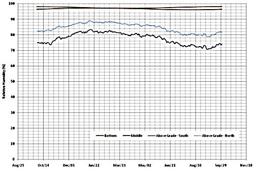

Because closed-cell spray foam is an air and vapor barrier, there are no risks to air leakage or vapor diffusion condensation. The concrete is unable to dry to the interior through closed cell spray foam, but concrete is generally not affected by a high moisture content. Figure 2 shows the relative humidity in the middle of the foam does not exceed 80%, which means there are no moisture related risks from vapor diffusion.
Figure 2: Predicted RH in the interior surface of the foundation wall of closed-cell spray foam
