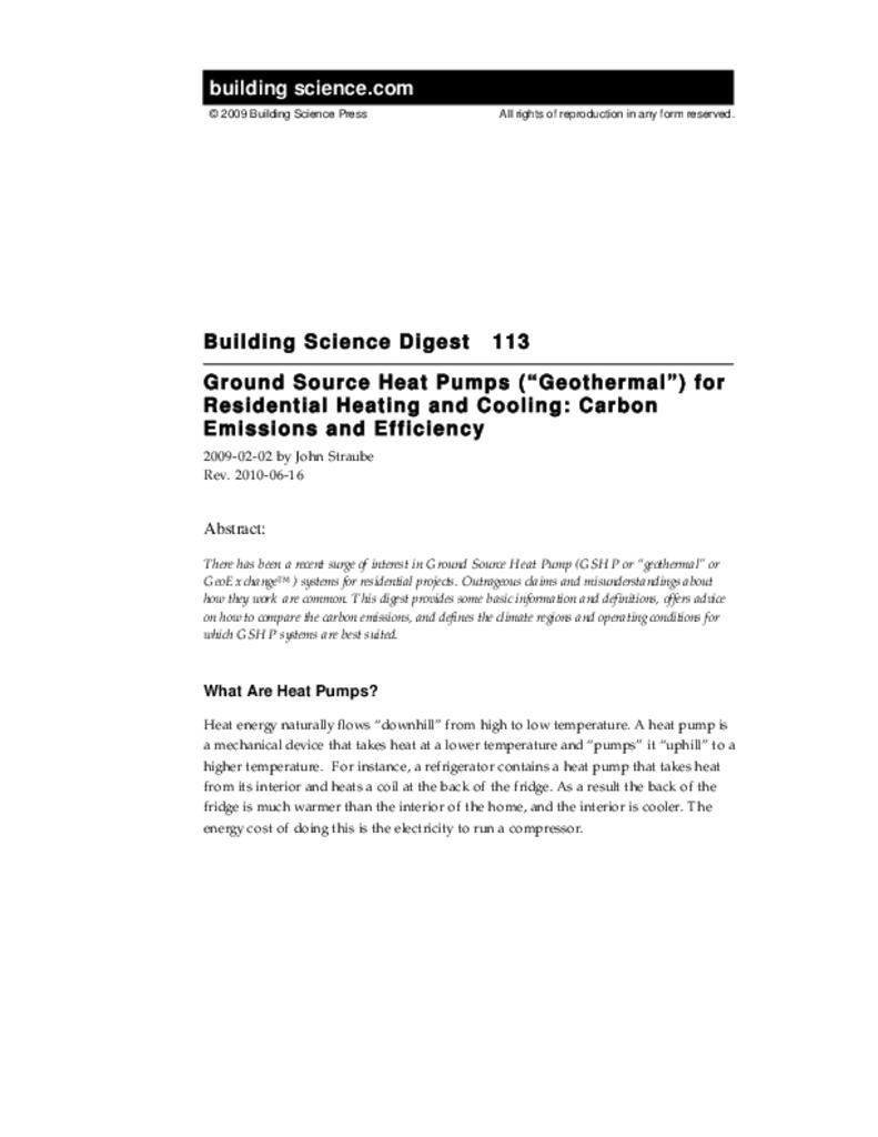

BSD-113: Ground Source Heat Pumps ("Geothermal") for Residential Heating and Cooling: Carbon Emissions and Efficiency
There has been a recent surge of interest in Ground Source Heat Pump (GSHP or “geothermal” or GeoExchange™) systems for residential projects. Outrageous claims and misunderstandings about how they work are common. This digest provides some basic information and definitions, offers advice on how to compare the carbon emissions, and defines the climate regions and operating conditions for which GSHP systems are best suited.
What Are Heat Pumps?
Heat energy naturally flows “downhill” from high to low temperature. A heat pump is a mechanical device that takes heat at a lower temperature and “pumps” it “uphill” to a higher temperature. For instance, a refrigerator contains a heat pump that takes heat from its interior and heats a coil at the back of the fridge. As a result the back of the fridge is much warmer than the interior of the home, and the interior is cooler. The energy cost of doing this is the electricity to run a compressor.
